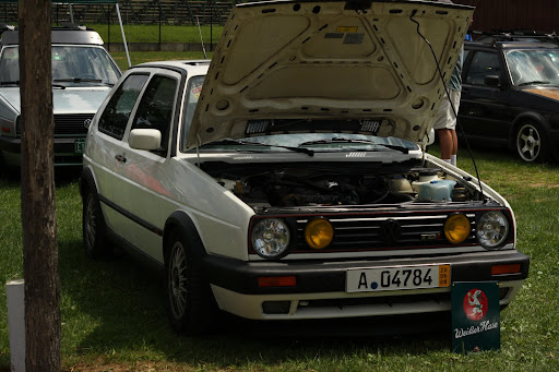

    European Car magazine readers may recognize the red Audi 90 Quattro coupe parked next to my Gti from this month's issue...nicknamed "The Crow"..even with a melted #5 piston, it is still an awe inspiring machine, with a bark so loud from its 4" side exit its beyond comparison
    [IMG]IMG_0052[/IMG]
    [IMG]IMG_0073e[/IMG]
    [IMG]IMG_0055e[/IMG]
    [IMG]IMG_0106[/IMG]
