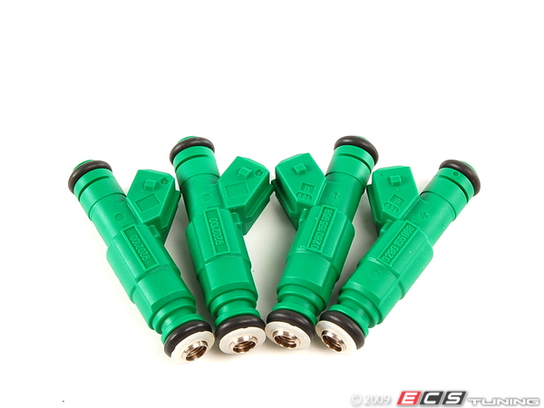

    what injectors you runnin?

    Bosch Green Giants 440cc
    A drop in 440cc fuel injector, commonly referred to as "Green Giants"
    Green Giant 440cc/minute commonly used with self assembled big turbo kits. Customers have had good success combining these injectors with VR6 MAF housings with stock or standard chipped programming.
    A direct drop in fuel injector for the standard fuel rail, no spacers needed.

    ok sounds good. I was told to run audi tt injectors. you would recommend those over the audi tt 386cc?

    We originally ran 386cc. The duty cycle was near 100% during testing. We opted with the Green Giants and before too long the UNI STG2 440cc file was made as it is today. The key here is FT + UNI + W/M = a kickass tune that won't break the bank. 285whp is enough for me on DD with FWD.
