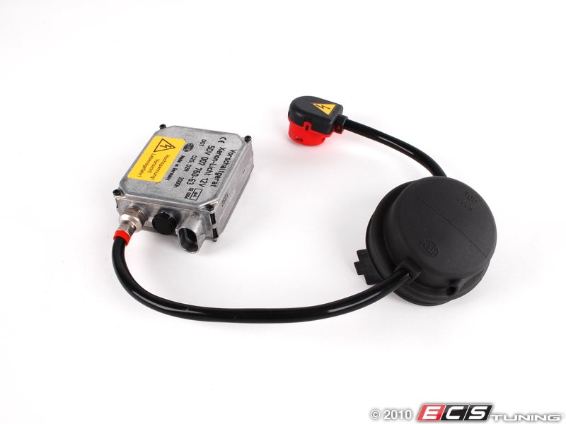

    these ballast are on sale, could I use them for the fogs? will e-codes allow me to do HID as driving lights? Because it'll produce a clean line across the road?
