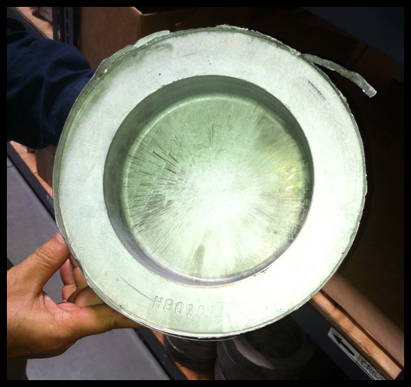

    When I started modifying my car, I told myself I wouldn’t add any parts that don’t exceed OEM quality. Weight reduction can do wonders for performance. Since I have my suspension and tires in a decent place I figured the next best mod would be to reduce the weight of our heavy R32’s. I’d previously removed my back seats, so I quickly revisited that option. Next in line are some lighter wheels, brakes, and most likely pullies, but those are a different story. I quickly learned that most of the drilled/slotted rotors out there are weaker due to their drilling/slotting. So I decided to stay away from those and stay with the durable OEM rotors.
    I recently stumbled upon a thread regarding potential development of lighter front rotors by a company in Fullerton, California named RacingBrake. I’ve really wanted to get set of 2 piece rotors, but no one makes them. I feel the R32 brakes are more than adequate through track testing, the only downfall are the heavy rotors. We all know how much light weight wheels can do; lighter rotors/hats are the same concept and help just as much. I reviewed the RacingBrake site for technical info and read through testing a BMW owner had done. He seemed to cover all the typical aspects with his testing which gave me a good feeling about RacingBrake products. You can read more here: http://www.e90post.com/forums/showthread.php?t=474395
    I posted if they need any testers and sure enough their first lead was back east, so the opportunity came up for me! Here’s info from my test fitment.

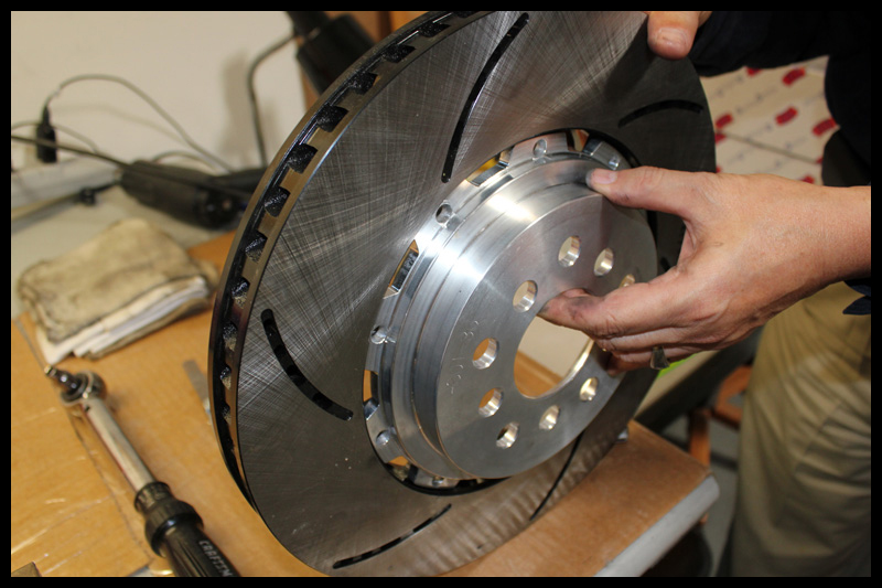

    RacingBrake QA Fitment Test:
    I headed down to Racing Brake for my test fitment on Tuesday for the MKV R32 2 Piece Front Rotor replacements. RacingBrake walked me though some of their development process. I was very impressed with their knowledge, material use, attention to QA, and overall design. RacingBrake expressed that they’re a brake company that’s here to provide solutions that other brake companies refuse too, which is great for our small VW community.
    The fitment was a success and they should be available within 2-4 weeks.

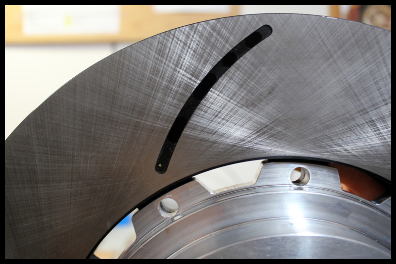

    RacingBrake Rotors:
    the discs are made of a very durable material with a Brinell rating of 200-220 (SAE std 187-241). They’re heat treated to relieve residual stress and further enhance the microstructure uniformity before they are machined.
    The rotors feature a mounting system which isn’t mounted to left or right surfaces of the rotors, but they are mounted in the middle of the rotor. This feature draws air in from both sides of the rotor, unlike OEM and most aftermarket which can only admit air from 1 side (inboard). Mounting in the middle also helps prevent warping, balancing stress and heat load as well as heat transfer. The discs are directional but could be used on either side of the car; you would just have to flip the discs because they are uni-directional.
    Rear Rotors:
    The directional slots are staggered from left and right sides on the same rotor so they’re not impacted by weakness and proven more uniform temperature across the rotor surfaces. The slots also feature holes in them, which is one of RacingBrake's patents. This feature provides a way for the brake dust to not build up, clog up in the slots, and come right out through the vanes. The rotor vanes also have a special design that even out the flow from the inside all the way to the outside so the air and dust can escape and keep the rotor at consistent temperature on the inner and outer parts of the rotors. They also are reinforced for strength which is very important.
    RacingBrake Proprietary Rotor Slot/Drill Benefits:
    • Allows the disc to expand and contract and prevents the disc from cracking or warping
    • Increasing cooling area and retains more friction surface
    • Slots relieves thermal stress
    • Slots are self-cleaning and the pad build up will not clog the slots and are exhausted via the rotor edge keeping the disc surface clean
    • Reduces brake pad dust buildup and keeps the wheel clean through vacuum effect
    The hats are machined from raw forged high quality 6061-T6 aluminum alloy, and are larger in diameter than OEM providing a more balanced hat to rotor setup than OEM, again this makes them more durable and able to deliver higher brake torque. The picture below is of the raw forged blank before machining.
    Compare the R32 Replacement, OEM R32, and GTI Replacement on the right, notice how large the hats are compared to OEM. The pictures below are prototypes with uncoated hats. They also coat the hats with EDP (Electro-Deposition Paint) providing optimal result in durability withstanding over 500 hours in a salt spray test.

    Thanks for the write up. Are the slots cast in or machined post-casting?

    without getting into a debate, they're machined. I have to say RacingBrake's process has been successfully proven on super muscle cars (500 HP+) like the Corvette Z06/Viper and fast motorsport cars like EVO8/9 and 10.

    Thanks for responding. Not looking for a debate, just curious because of the color finish on the inner surfaces. Looks like a high quality product and I hope to buy a set

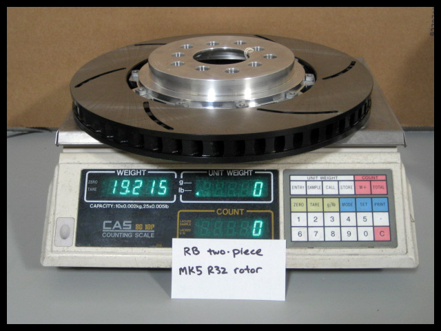

    How much does the OEM rotors weigh for comparison?
  17. Banned BetaOp9's Avatar
    May 4th, 2006
    5,413
    2008 VW R32 [TR #2392]
    03-18-2011 11:04 AM #17
    Quote Originally Posted by AudiMark2006 View Post
    Quote Originally Posted by JC@DouglasVW View Post
    Here is a weight on the stock rotor.
    Fronts
    Rears.
    ¤ Posted via Tapatalk on my Samsung Vibrant ¤
