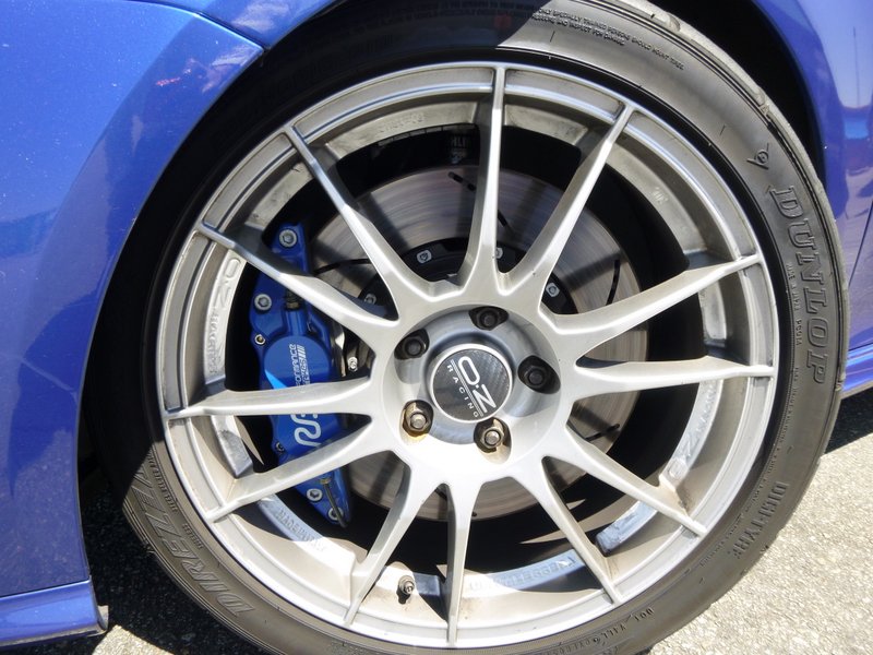

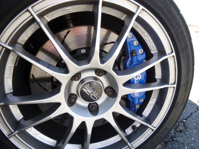

    06-04-2013 11:30 PM #409
    Mine, from WSIR/Fastivus:
    Quote Originally Posted by petef View Post
    ... you have no way of knowing whether the previous owner(s) was a civilized driver or a hoon like Peach.
    Quote Originally Posted by Dave Barry

    RB makes the tolerances so close that they realized there are manufacturing differences, some R's have it more than others, so designing the rotors not to have a large rust ring makes it really difficult. The caliper like Mr_Peach has fits perfect.
    They're a little different than the MKV.
    The benefits of the rotor and weight far outweigh a couple mm of overhang, I tracked mine like that for more than 10 events while occasionally street driving as well.
    Google pad overhang and most people will say it's not an issue.
    Have you tried to adjust the bracket like I mentioned?
    Quote Originally Posted by deepclue View Post
    Just in this morning:
    http://forums.racingbrake.com/showth...=4908#post4908
    The post seems to suggest that the Golf R's caliper is different from the MkV R32, and I don't know whether that is accurate since I do not own a Golf R, but I can attest that my MkV R32 suffers from the same problem with these rotors. On RB's web site the rotor is listed as 348mm, but from what I gather the MkV R32 and the Golf R OEM rotor is 345mm. That alone could explain the offset friction surface I described above, if both rotors have the same surface width, resulting in an effective braking surface of 342mm (I have not measured any of this).
    Not happy.

    Quote Originally Posted by Ryan E. View Post
    I saw your recommendation (thank you!) but I just don't see how one can move the caliper carrier even a fraction of an inch--the bolts leave no play. Did I misunderstand?
    As for your explanation, are you implying that German auto makers somehow manufacture with larger tolerances than RB? I find that VERY hard to believe. To me this is all very simple: it's a re-use of the BMW rotor design on the VW disregarding the fact that they actually have a 3mm difference. Who can blame VW for not making calipers in the Golf R that clear rotors that are a full 3mm too large? So much for close tolerances.
    Mr_Peach's fit perfectly because he's using RB's upgraded calipers as well, which I bet take different pads. That's a $1,500 proposition, and in my case it would probably place me out of the STX solo class I run in.
    As for the pad overhang, instead of doing an Internet search I contacted Hawk's tech support in regards to the HP+ pads I use. They warned me that the overhang could eventually cause the pads to fail to separate from the rotor when releasing the brake pedal, and they recommended that I go in and file the overhang manually every now and then. I find that completely unacceptable.

    Yes, there's some play in the 2 large bracket bolts, loosen, pull towards front of car while snugging up.
    Tolerances in regards to rust rings, outer and inner.
    Golf R different car, slightly different rotor.
    Good luck!

    I just looked at mine again and I do have some overhang. I'll try readjusting the carrier.

    Today I took them off the car, packed them, and sent them back. I had to file the pads so they'd be flat again. Interestingly, my old ATE PremiumOne rotors feel like they give me more bite than the RBs did.
    There was no play on the caliper carriers.

    Looked closer today. Overhang is maybe 1.5 mm. I didn't bother trying to adjust them.
    Sent from my iPad using Tapatalk HD

    Yeah, that's not worth the effort, completly fine .
