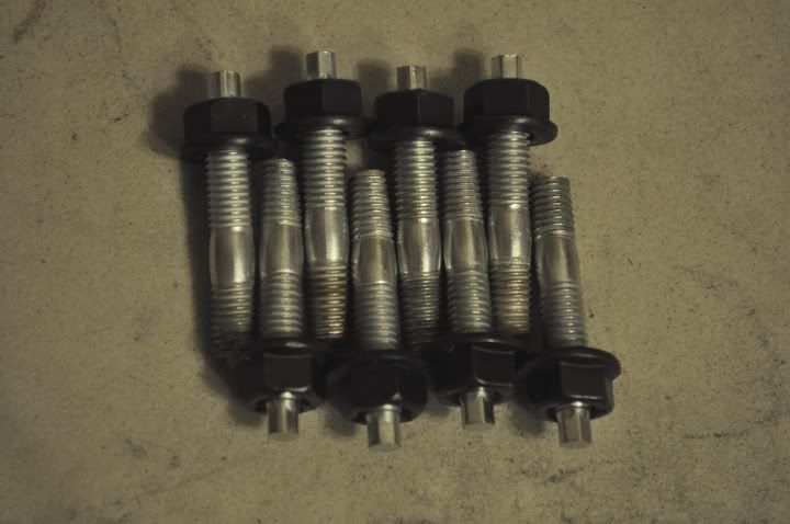

    Small update here guys.
    Seeing as how I had to torch some of the nuts to get the exhaust manifold, I had to go out and get some new exhaust studs.
    I went to go put them in and I realized they weren't gonna go all the way in, the studs were too long.
    So the mighty dremel comes to the rescue again!
    From top to bottom: Shortened new stud, old stud, out of the box new stud.
    Got them all shortened.
    That's all I was able to do because of the rain again today here in Florida.
    BUT, tomorrow I should have the turbo mounted so I can start mocking up charge piping and such.
    Take care until the next update
