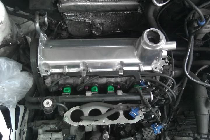

    Small update here again.
    Got my slim fans in , I think they look TONS better than the oem setup. Mine was all rusted and too bulky.
    And refitted my Air/Water Radiator so it looks like this.
    I think it looks pretty damn good.
    It's Timmy with mmmmMojo, i have returned
    8VALVETURBO - Sorting the kinks out.

    Yes. Definitley looks pretty damn good. How did you mount the fans? And how was it wiring them? Easy/difficult?
    I like the way it looks and looks to be more spacious.

    They're mounted with standard radiator ties, the same thing you'd mount an oil or trans cooler with.
    I like the space too , but I needed the space, the OEM setup hits the a/c lines and some other things when you move back the radiator and condenser back an inch or two.
    As for wiring, I haven't got at it yet, I want to use the stock 3 wires clip that clips on to the OEM fan assembly but I'm not sure how I'm going to attack that issue.
    Could somebody possibly help me out with that?

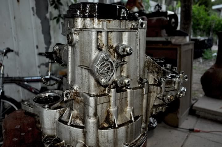

    Not much again,
    But today I got my 02A tranny and other related swap components delivered. Holy **** that box was heavy.
    Process is going slow, I want to get this thing running before SOWO, if I don't I wont be able to go.
    ECS is also pissing me off by not processing my order yet, I NEED that rear motor mount.
    I got something done today, I modified the brackets that hold the plug wire organizer thing to work with my mk4 valve cover.
    Tomorrow I will be installing my walbro inline fuel bump, trying to route my water lines, maybe some other small stuff, still trying to get in contact with the company I bought this kit off of, so I can get my money back and get to real progress.

    What trans code did you end up with?
  18. Member AJmustDIE's Avatar
    Dec 22nd, 2010
    Ocala, Florida
    2,144
    Eight valve like WHOA.
    04-20-2011 03:14 AM #123
    I'm not sure to tell you the truth, I haven't even dove into the box yet. Where can I find the code on it?

    It will be on the front of the case. 3 letters. Reason i ask is that the ratios in the 4cyl boxes usually aren't the best. Depending which one you get, it can go a few different ways. Lots of improvement to be had with some vr parts in there.
    http://www.vwtransaxles.com/code.html

    its off an mk4 2.0. block code aeg
    http://forums.vwvortex.com/showthrea...2.0L-ABA-OBDII
    2 for sale (not mine) http://forums.vwvortex.com/showthrea...choose-from%29
    i found a full swap at show and go here in jersey for 100. also there are 2 different valve covers one just looks like an aba cover but w/o the pcv hole? ill take some pics.

    So just thought I'd throw up some pics of the 02a swap. It will definitely be cleaned and painted before being put in.
    Still not exactly sure what code 02a it is, there maybe grime covering it up or something.
    If somebody could do me the service of opening the trans pic on paint or PS and showing me where on the trans I could find the code that'd be much appreciated, I can't find anything on google or on here.

    Ok guys looks like I have a CES code 02a,
    1st, 3.778 | 2nd, 2.118 | 3rd, 1.429 | 4th, 1.029 | 5th, 0.837 | R&P - 3.684
    I got to cleaning it today and I got a lot of the grime off, but I'm probably gonna end up using a pressure washer to get it perfect for paint.
    Hey rootbeer what's the word on having a CES code? Good/Bad ?

    04-22-2011 10:04 AM #132
    _________1st___2nd___3rd___4th___5th___R&P___Notes
    CES====3.778=2.118=1.429=1.029=0.837=3.684== Passat?
    couldnt find anything else to verify those.

    04-22-2011 10:31 AM #133
    Yea, that looks right. That's good, that's one of the better ones to have. Short 3rd is good. Shorter 4th is good in terms of 4cyl boxes.
    Only weird thing is that with a 4cyl box, you've got a short 1st and 2nd. If you ever consider tearing that box apart, i'd suggest a long vr 1st and 2nd( 3.3, 1.944), and the even shorter vr 4th gear 1.034.
    Yea, that's all from memory

    04-23-2011 04:34 AM #135
    That's awesome, thanks for showing me that. For some reason it didn't include my 5th in the link but I fixed it when I arrived at the page. Looks like with upgraded valve-train I'll be able to go a little over 150 lol as if I had somewhere to even try.

    Got some pics of the freshly cleaned/painted 02A,

    Started the day with painting the trans, as you seen before this post. Decided I wanted to get some more work done on the car today.
