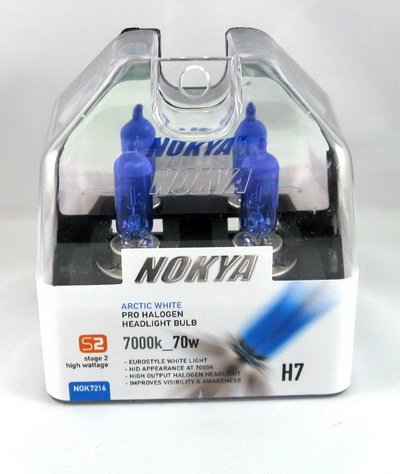

    08-26-2012 10:45 AM #102
    heres my alternative if you guys have halogens:
    GET THE HID LOOK. WITHOUT BLINDING ANYONE
