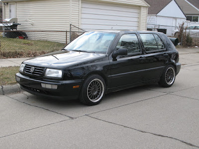

    Thanks. Should be coming out of storage in the next week. I've got a bunch of stuff waiting to go on . Stay tuned for updates.
    In the off season, I built a new low budget DD and sold the A4 to free up some cash.
    The thread for that is here:
    http://forums.vwvortex.com/showthrea...w-MKIII-Member

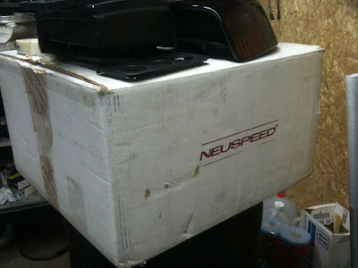

    Yep. Just went to PG today and pulled the harness from an OBDII car. Got the Chip and injectors in the mail the other day. 5 lug first need to get those wheels on. Got a set of MKIII speedlines for track day fun.
    I need to get this Deezl out of the garage so I can bring her home.
