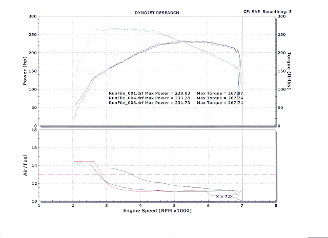

      Here was my first dyno session on 93 octane fuel and file on APR Stage 1 back in November/December 2010. (I never had a stock baseline )
      Mods at the time:
      Carbonio/APR Stage 1 intake, Noisepipe delete, and forge diverter valve spacer.
      93 Octane tune: average of 232whp and 267.6wtq

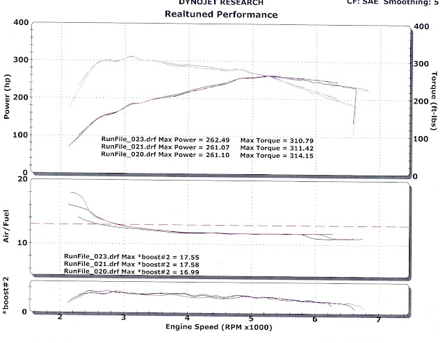

      93 Octane tune: 247.86whp and 275.72wtq (I need to call the dyno shop and get them to send me the file with the Torque curve since it was left off accidentally while printing the graph)
      details
      100 Octane tune: average of 262whp and 312wtq
      details 1
      details 2

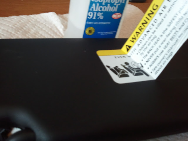

      sun visor diy: http://forums.vwvortex.com/showthread.php?4791409
      use 91% Isopropyl Alcohol (rubbing alcohol) or straight up acetone.
      my pictures:
      after removal
      getting remainder of glue off
      visor #2
      visors side by side showing remainder of glue

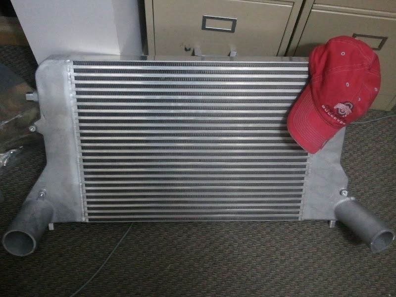

      APR FMIC was larger than expected

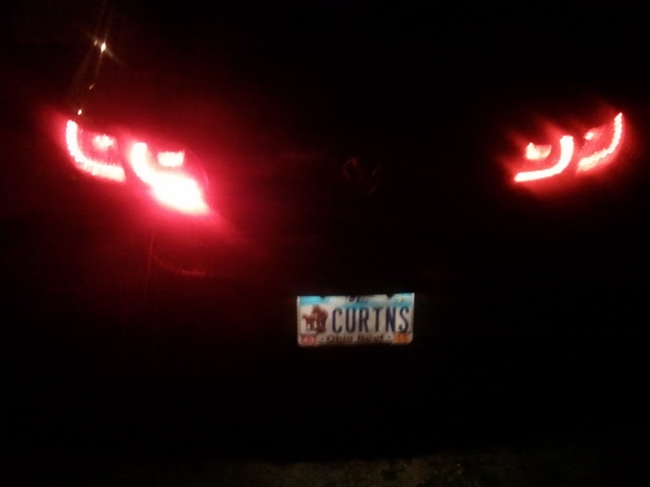

      LED tails received and installed 6/21/2011

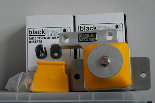

      Nothing like having a motor mount fail...
      BFI stage 1 passenger motor mount. The shaft is actually bent as well. I have a bunch of pictures.
      About 2,500 miles on it.
      http://www.youtube.com/watch?v=IQHjo0l_uv0
      9/01/2011
      Old sad broken stage 1 motor mount left (semi-disassembled) new happy stage 2 motor mount right.
