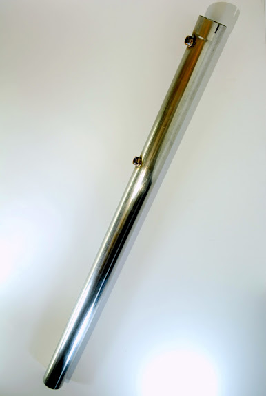

    HS Tuning Cat-less mid pipe made of 304L tubing. Weight savings of 4lbs over my catted mid pipe. I'll be using this for track sessions
