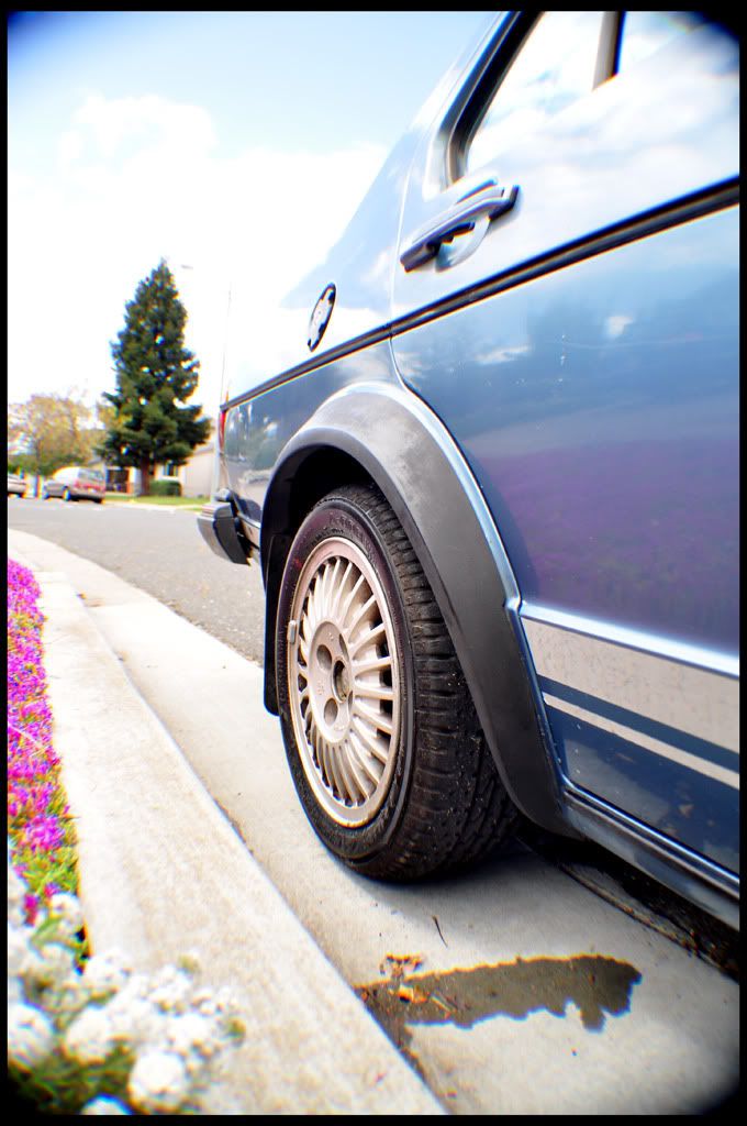

      Then lowering:
      Then new rims:
      Then even more lowering:
