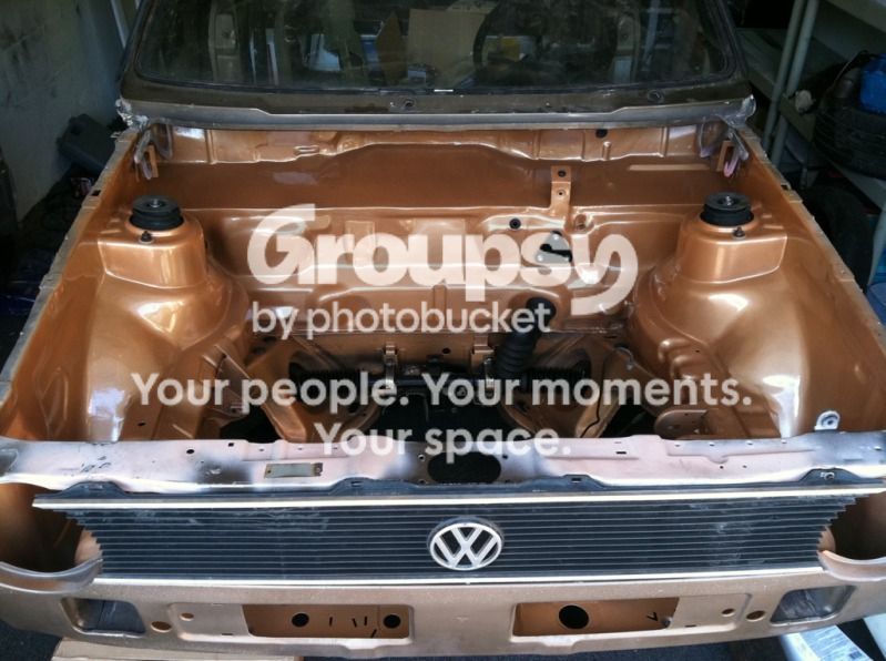

    Soooooooooo..........
    With this from MjM....
    I went From this:
    To this:
    FINALLY BACK ON THE CAR!!!
    Strut inserts, hubs, and wheel bearings should arrive by Tuesday.......hopefully back on all four before Christmas

    Bag, VERY little progress---but sharing what I have done......
    First two P-sluts finished, not bad for doing them myself(IMO)
    Likely to receive some Hate, but I wanted a fresh look for an old wheel
    In the car, not much of anything new.....got my brake booster block-off plate installed and FINALLY got my hands on the grille I've wanted forever!
    Did manage to get sort of start on exterior prep----front fenders are now dent-free, shaved, and skim-coated
    The DUI moron almost killing my wife & kids and destroying the passat has put a strain on my progress, but I did pick up a new daily (wife gets the MKV ) to enjoy until the cabby is complete
