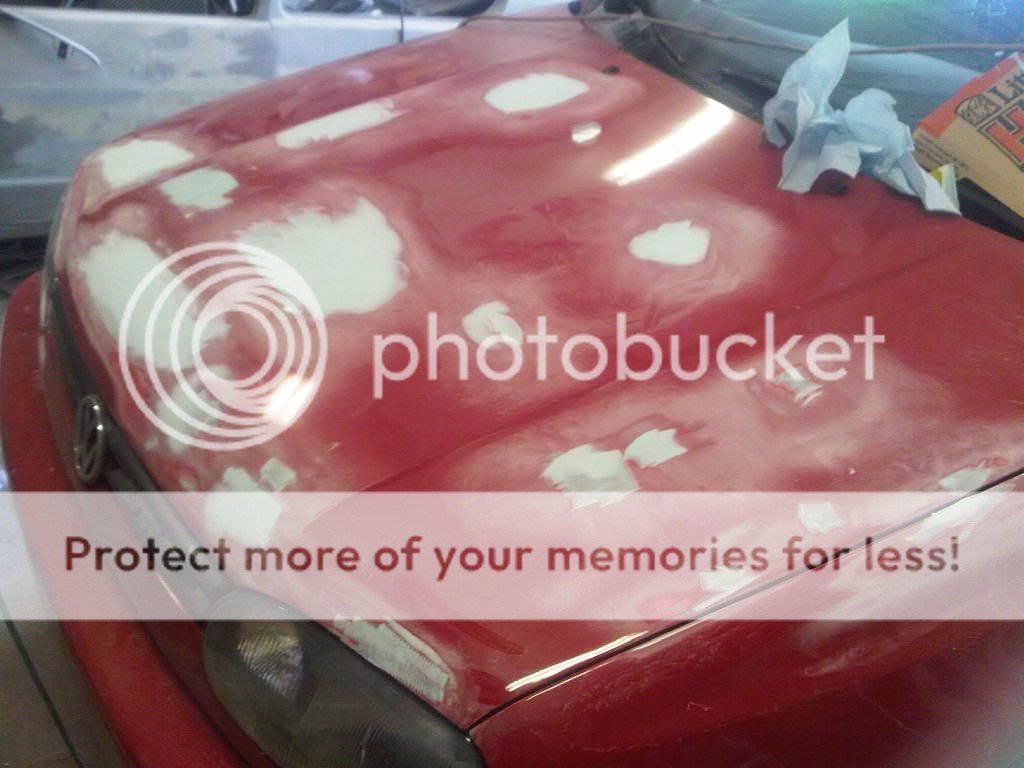

    I'm glad you are happy with my bodywork. That hood had more waves than a god damn ocean. I think we got them all though.
    Anyone with an MKIII with rotted rocker panels, the rockers are not the only thing rotted! The floor and other mount points are rotted too.
    This car took a lot of bodywork. The two lower fenders were rotted, wheel wells had hole, wheel well lip was blasted, gas cap area was lasted.
    New rear floor pans, structural support was replaced as well.
    While I was working on that and waiting for stuff to dry, we went ahead and fixed all of the dings on this car. The sides look like someone played morse code down each body line.
    The roof was in perfect condition and required 0 work though.
    Can't say it enough. Phenomenal work = understatement.

    here's a link to my 1st MK3 Rocker Job. http://www.mk1dubz.com/forums/showthread.php?t=642
    That car took me 3 months. New Rockers, Floors, Dent/Ding removal, Shaved door handles, Shaved rear hatch, Shaved license plate area, gas filler, Shaved the side bodyline as well as the gutters on the roof, all perfectly smooth.
    Oh, we also modified the hood.
    The hood follows the contour of the car and covers the headlights. This took a little bit to get it right. There were two bends in it, so it took some time.
    Don't even ask me how much, because you probably couldn't afford it, that entire car was a major project.
    Oh, forgot to mention I also had to replace the rear QTR panel as well as the inner wheel well.

    Quote Originally Posted by EL CAPO View Post
    any more pics of the hood process?.... apreciate it....
    good luck bro
    The boser? Not mine so I can't help you there. But Bob did my hood perfectly, this is the only pic I have right now:
