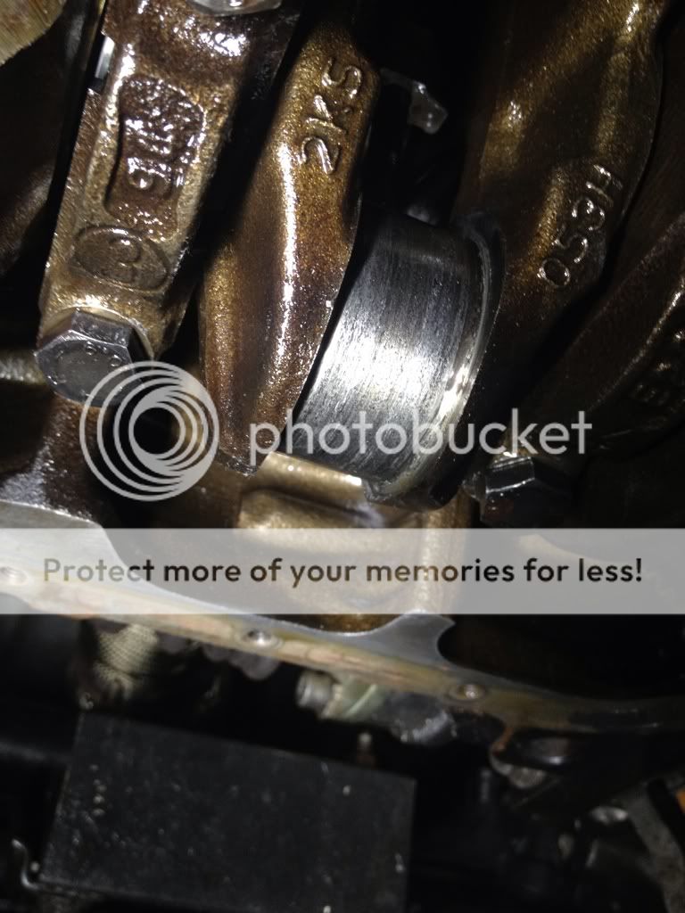

    05-07-2012 09:05 PM #334
    Ka Boom!

    05-07-2012 09:26 PM #335
    Quote Originally Posted by vwflygti View Post
    Ka Boom!
    Freakin sux man
    Do you know what happened?

    05-07-2012 09:41 PM #337
    Quote Originally Posted by Sr. Karmann View Post
    Freakin sux man
    Some rattling and loss of oil pressure, I'm gonna guess rod bearing spun... Will know more tomorrow....

    05-07-2012 09:50 PM #339

    So, motor was totally locked. Steps taken:
    1) Remove timing belt, top end was free.
    2) Intermediate shaft was free.
    3) Bottom end would not budge.
    4) Drop oil pan, pieces everywhere.
    ~wait pieces are plastic! WTF!?
    ~wait where is the oil baffel? up in the crank!
    5) Remove oil baffel, millions of little pieces.
    6) Motor still no budge.
    7) Loosen rod bearings, motor now moves.
    8) plastic pieces in oil journals of crank.
    9) remove rod caps. oil starved and spun bearings.
    Crank seems pretty bad, don't think emery is going to clean it.

    Ouch, makes me re-think my plastic baffle, although it is brand new, doesn't quite look like that one tho.
    mine

    That Sucks... That crank is DONE.
    why did the oil pressure drop causing the rod bearings to fail.
    I would use the aftermarket windage tray/oil pan gasket and ditch the oem baffle.
    Also a great idea to lock tight the oil pump bolts.
    Looks like you are looking for another crank and rods?
    block and pistons should be OK.... Sucks you gotta tear it all down and start again.

    Quote Originally Posted by REPOMAN View Post
    Getting metal baffle.
