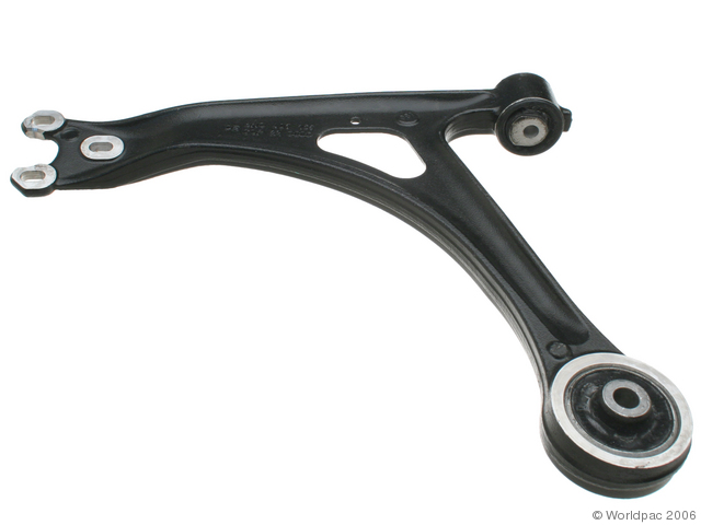

  23. Moderator SLC4EVER's Avatar
    Oct 7th, 1999
    San Diego
    14,466
    '93SLC '94SLC
    09-12-2011 06:12 PM #128
    You got me all excited that an alloy version exists.
    Dak
    I drive waaay too fast to worry about my cholesterol.
  24. Member TheBurninator's Avatar
    Jan 7th, 2009
    Colorado
    12,321
    Corrado, Mk1, LG5U Mk3
    09-12-2011 06:22 PM #129
    Quote Originally Posted by MikkiJayne View Post
    Now I can't find a single pic of an unpainted one It must have been a mk2 TT one I saw.
    I'll get my coat
    That the arm you were thinking of?

  27. Member MikkiJayne's Avatar
    Jan 1st, 2007
    UK
    9,377
    A6 TDI Quattro wagon, A4 V8 Quattro racecar
    09-13-2011 04:57 AM #132
    I don't think so. I've seen those before and knew about the different rear bush. I was absolutely convinced I'd seen an alloy arm that would fit the 'rado but with no sway mount. It must have been the steel one though, since I can't find any pics of anything else
    Throw an Audi engineer down a hole with a ladder and he will fashion a shovel from it and tunnel his way out
