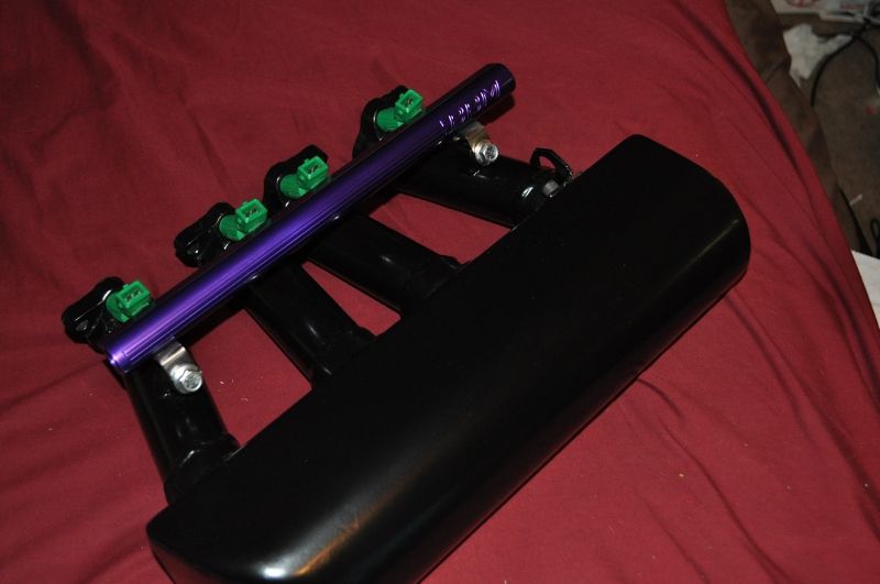

    Looking into adding a SRI section. Maybe a feedback section?
    Say, if you have a C2 chip, or a eurosport intake. You can give your feedback on the item, and I can add it to a list. Something like
    Eurosport intake , , ,
    Neuspeed intake
    Something like that.

    For the SRI section, you could list all known premade units and then list Ross Machine Racing's site for the DIY guys.

    Quote Originally Posted by AJmustDIE View Post
    Yeah, I'm trying to find more info on the HKK one. The USRT one is a very nice piece.
    911_fan would know. He ran and dynoed both. I could be wrong, but I thought all the original USRT ones were made by HKK. Kind of custom pieces and not really production. He was taking stock lower manifolds as cores.

    Paging 911_fan!
    I know from experience that the USRT piece is very very nice.. I don't know if any other companies really make a "good" one. I don't want to bother adding a place that says "buy a generic DIY intake manifold" because it's definitely more involved than the average person can do, and there is science behind it. I wouldn't run a home made SRI, unless I built it and made it from R to D.

    It's not hard to do... if you can make measurements and can weld, or have somebody weld for you it opens up a whole world. Screw paying $700 for something that I built for $300, and **** on it in terms of flow.
    Colm, this thread shouldn't be carried with the attitude of "something your average person can't do and won't be included" kind of thread. Those kind of decisions should be left up to the people attempting such things. If they feel it's too much for them well then maybe it is, that's not to say it shouldn't be included among this resource bin for ambitious people who don't want to puss(y) foot around and actually want to make power.
    You're right.
    I'll try to look into some DIY kits. I know BBM sells one, and I'm sure ebay does too. Using the stock lower intake manifold/fuel rail makes things a bit easier if possible.. I suppose it wouldn't be too hard.
    I just think they can go wrong easily and you can starve cylinders if you don't know what you're doing, you know? It's like playing with fire.

    the mk4 lower manifold is smaller at the head than it is at the union of upper and lower creating a venturi effect
    thus making it a better place to start a diy sri
    just a thought
  34. 05-29-2012 09:42 PM #315
    The HKK ones were like $400 or less with core when they were being made. I don't think they were that sophisticated of a design. The USRT ones were an improvement, but the same guy, Greg Haley from HKK/SVi Welding, was making them as far as I know. The latest USRT long runner ones are someone else I'm pretty sure. I don't remember whole story but I remember people having problems getting work and parts back from Greg. Schimmel makes them too. I don't know about for a 2.0, but money talks.
