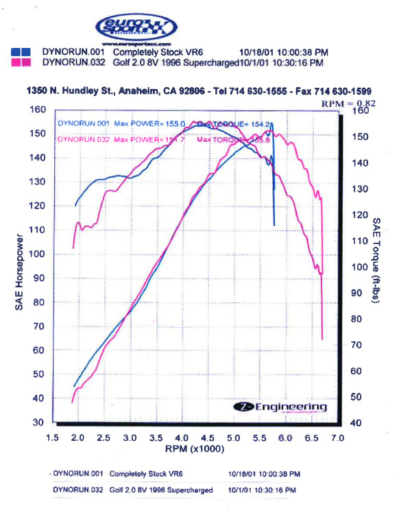

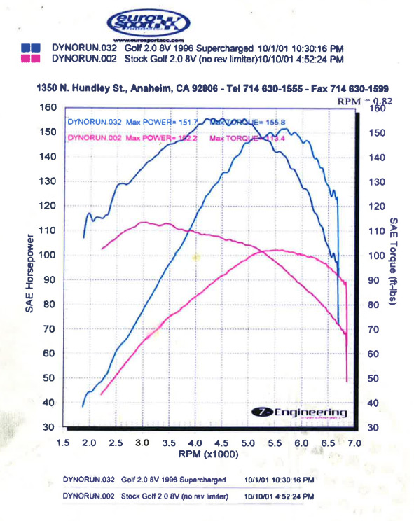

    For the supercharger section, you can also add Z-Engineering and it's successor, the RSC by Ruf-Kompressoren. I don't think anyone has ran the RSC on an ABA in the states yet. It costs around $2500 new with bracket and is supposedly a 70-100hp increase:
    http://www.ruf-kompressoren.com/wb/p...percharger.php
    Dynos of the Z-Engineering on stock engine:
    The Z-Engineering kits originally came with the ZR1 charger, which they used both on 2.0 and VR6, just a different bracket setup. It was later upgraded to the ZR2 model that used a cogged setup instead. Original ZR1 chargers that were replaced or repaired under warranty were upgraded to the cogged setup as well. When VF-engineering bought Z-Engineering out or whatever, they had a charger exchange program also.
    New these ran close to $3k I think. They go anywhere from $600+ these days. I've seen some try selling damaged used ones for over $2k on rarity, but I picked up two complete kits with a bunch of extra parts for just under $2k total. They run around 5-8psi with no upgrades.

    Quote Originally Posted by zero. View Post
    Aren't these centrifugal? I've never really looked at these, but I've seen VR6's run them.

  24. 06-03-2012 11:44 AM #339
    Quote Originally Posted by Hurt View Post
    Yes, they are just like the Vortech and VF chargers except you don't need to run an oil line as it's self-contained. On the plus side there is plenty of space to run an SRI.
