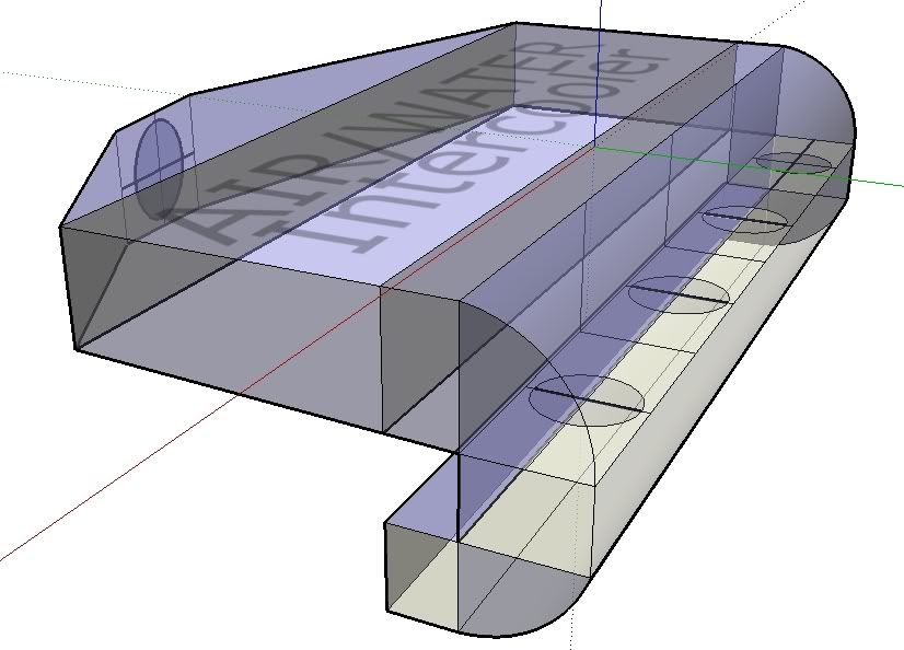

    Just a rough sketch, but thats the idea I'm hoping for.
    Quote Originally Posted by nubVR
    So.... got some pics. IC is big, just like i thought it was gonna be. When i recomended the IC we picked, it was based on the first pics you showed me, from bulldogger.... with the core in front of the runners. So keep that in mind when we figure out what were doing!
    First pic, just for size compare and layout, there is about 1/2" i can go down
    angled a little... notice where still really high! Measurment is from bottom of the head, it is also sitting flat on the table, not at angle like the block
    I'm hoping we can chop the core down a bit, or I may just get him another core to work
    We will end up running a bell core, and selling off the core pictured up.

    This is just the type of manifold I wanted to build, but I wanted ITB's as well.
    ROUGH draft.
