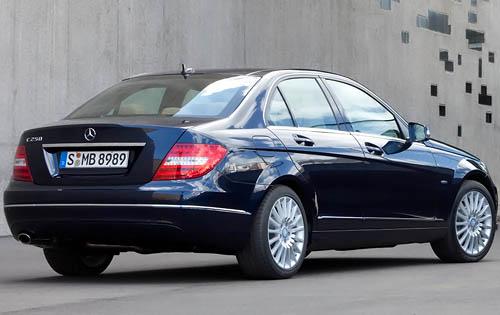

    Not my car but heres a pic
    As you can see above, the center part of the tails is always ON while headlights are ON. So the goal is to have the brake section (top part of the tails) be ON with the center part BUT with the same brightness. When brakes are applied, the top part (brake section) will simply light up brighter than the center.

    Ever seen a C-class sedan rear lights operate?
    It's more difficult to make the changes, because you have to modify the rear tray on:
    1) Accepting a dual filament bulb
    2) How it is wired up.
