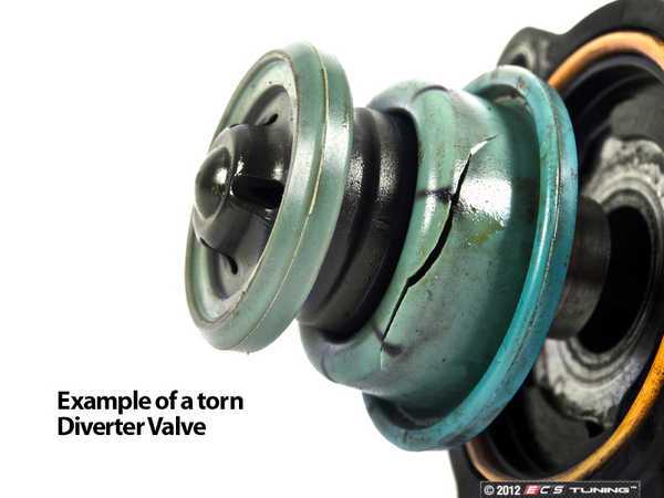

    Stock diverter valves just can't handle performance upgrades. Add a little boost and they get all weak in the knees and go to pieces.
    Forge knows this. That's why they've engineered boost-hardy blow off and diverter valves tough enough to take the pressure, without blowing their lids.

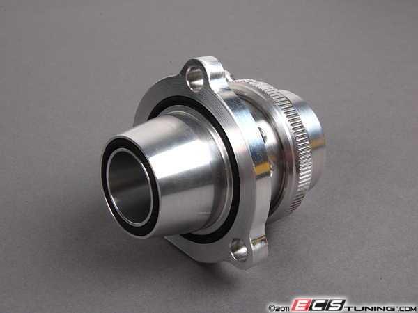

    You have a few options:
    - OEM D paired up with the Forge spacer
    - Forge BOV (upgraded DV/spacer all in one)
    Forge install PDF - Here
    After you decide what option to run, send me a PM and I would be glad to get you set up!

    These units are not made to "add" power only support other modification upgrades such as software upgrades, K04 kits, ect... where stock units can fail.
    As for the difference in sound - each unit's "sound" can vary please see our sound clips and DIY videos!
    With the small amount of air that will be vented with a BOV or spacer will not harm the engine or cause lag.
    The DV (Diverter Valve) is a pathway for boost when it's not being used by your turbo -
    When the throttle body is closed the boost needs to vent - Forge DV returns air back to the intake and the Forge BOV or spacer will vent to atmosphere. This BOV and/or spacer kit will be much louder over the stock and normal Forge unit.
    During the time that the throttle body is closed during deceleration if not letting the excess boost vent can back up and cause surge.

    The rubber diaphragm in the original diverter valve is prone to failure, even under stock boost pressure. You can see loss in throttle response and or CEL when the old unit fails. Restore lost boost with a new unit!
    Andy
