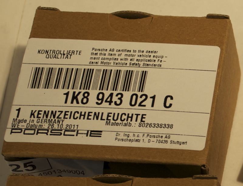

    Does not look like anyone actually answered your original question.

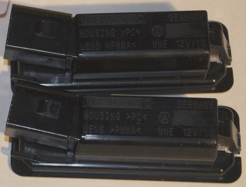

    YES, you can use the lower cost Porsche #1K8943021C, they are exactly the same as the VW version,
    in fact, the Porsche part has VW, not Porsche branding on the actual unit.
    IMO the oe/Porsche parts are very nice, not too crazy bright like some of the stuff out there.
    The units are completely sealed against the elements, factory harness plugs right up without adaptation,
    fit the bumper openings perfectly.
    You may or may not encounter bulb outs with these, disabling cold diagnosis helps.
    Seems some cars controllers are more forgiving than others,
    which leads me to believe these fixtures are borderline load.
    On mine, every once in a while they will trigger a bulb out, simply turning on the lights clears it.
    An added resistor to increase load/draw may be needed to completely eliminate bulb outs.
    packaging is Porsche
    branding on the part is VW

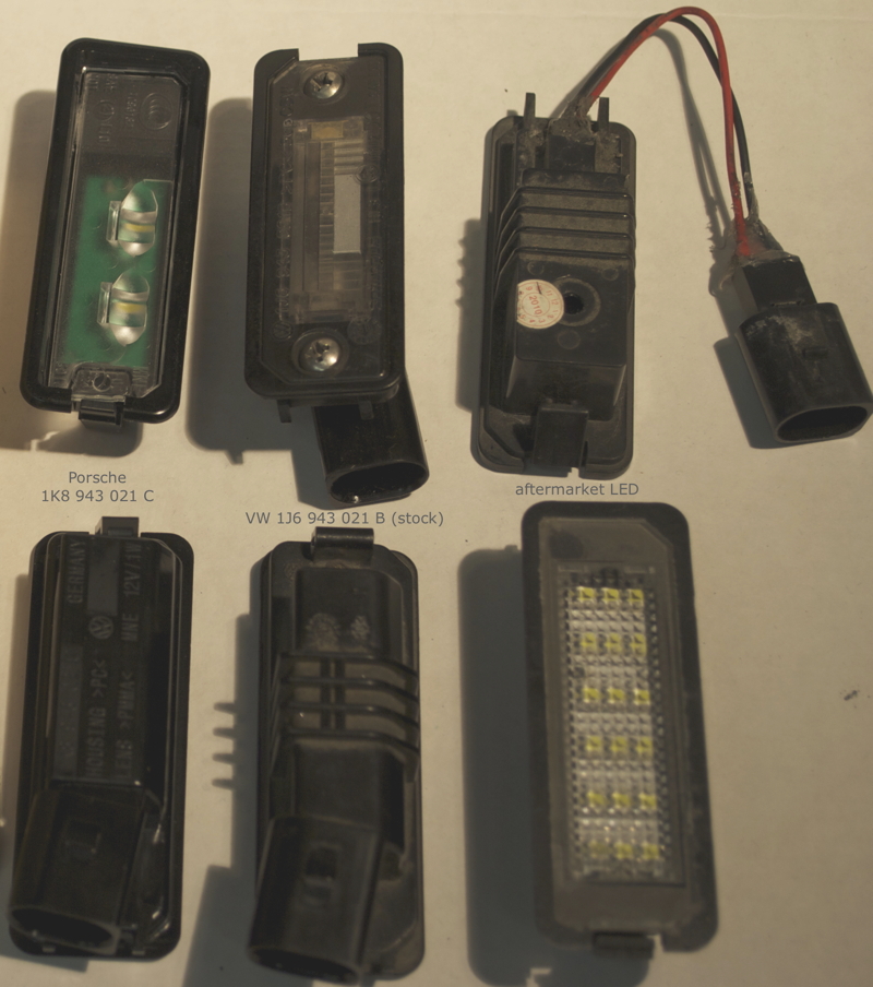

    comparison
