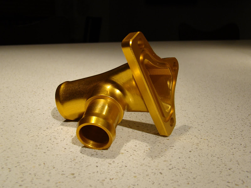

    Here's a water flange:
    Printed part for test fitting
    Billet machined part (5 axis, 2 setups)
    Polished
    Anodized
    Installed
    -Alex

    02-10-2012 06:25 AM #14
    Quote Originally Posted by 20v_boost View Post
    Nice piece of kit. Would this be commercially available? I'm rebuilding a 16v at the minute and I've already had to buy a new plastic one but I'm thinking metal would be more futureproof.
  8. 02-10-2012 04:19 PM #15
    I doubt anyone would pay what it would cost to make these like I did. A better way would be to machine the flange and weld the rest together. Either way it would be close to a hundred bucks. The plastic one is $8.

    02-10-2012 04:26 PM #16
    -Alex
    Easier way, not better.
    I would pay 100 for that work of art. Seriously! Don't underestimate the price some people would pay to do things right. You should see what it would take to produce a batch of them, then talk to James aka Dogger at Spoonfed Tuning to market these properly here on the tex.
    Nice freaking work!

    02-10-2012 05:35 PM #18
    Quote Originally Posted by sdezego View Post
    Nice freaking work!
    I think it would be interesting to simplify the design of them slightly and I think they be worth producing. Yes $100 may seem expensive but to be honest, I think if they could be made for about maybe $60 you'd be able to sell plenty. I wouldn't hesitate to pay for one.

  13. 02-15-2012 08:33 AM #20
    So you guys got me thinking about that water flange. The one I made does not replace stock, it takes a different path to go around the tensioner. I'm guessing that most people would want to customize theirs too so this is what I came up with. You buy the flange and weld on your own pipes, AN connectors, whatever you need. The flange costs much less to machine than the whole part and can probably sell for $50. Would there be any real interest in this?
    -Alex

    02-15-2012 10:18 AM #21
    I'm fitting ITBs to my 16v so it would be of interest for me to have something like that. What about putting either and inner or outer thread on the flange so a compression fitting could be screwed into it and it would allow the user to put a 45 degree or 90 degree bend or even a T piece onto it?
    What obstructions do we need to consider? Alternator, lower intake manifold, oil dipstick tube....
    I think I need to go out to my garage and have a look amy my head and block again.

    02-15-2012 07:54 PM #23
    Installed
    -Alex
    Nice work
    I am a huge fan of counter boreing to "hide" the head of the bolts. Might be an option for you to cut down on machine time and make a cool "flush" part.
