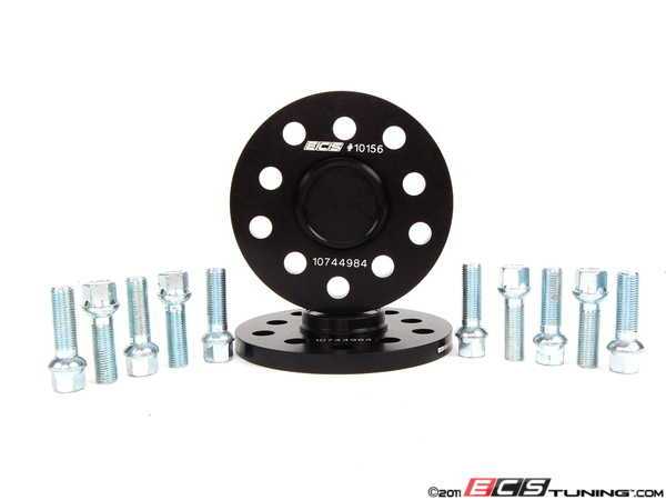

    Bought spacers, 10mm all around.
    Q: is it normal for the spacer diameter to be smaller than the wheel hub?
    10mm
    Spacer - 10mm
    diameter?
    don't mind the crappy iPod Touch low res pics.

    05-05-2012 12:49 PM #20
    finally bought spacers, 10mm all around.
    Is it normal for the diameter of the spacer to be smaller than the wheel hub?

    Keep it "square" all around. I'd go 10mm spacers on all four corners. I like ECS's spacers. Make sure they have the hub lip to avoid vibration.
