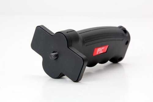

    The camera is still small though, and you'll want to really have a good grip on it to stabilize and feel at one with the camera.
    P&C Pistol Grip for DSLR cameras. Makes holding your camera a bit more intuitive like an old school super8 camcorder. (About $20)

    Just got my camera goodies from Amazon.
    The setup feels really good. The handle has a nice soft rubber feel to the finish. And the loupe is great.
