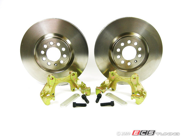

    ok so i'm going to be ordering the 4-5 lug conversion hubs.. I Have the 10.1 front knuckles and was going to run the 11.3 brake set up, but after doing some searching i think i might be able to run the 12.3 Audi TT setup..
    being that VR6 calipers/cariers bolt up to the 10.1 front knuckles, and the Audi TT caliper cariers bolt up to the MK3 VR6 front knuckles, technically the Audi TT caliper carriers should bolt up to the 10.1 front knuckles also? right?
    being that i have a 96 B4 passat donor car, still haven't checked but i believe they come with the DE 11.3 Calipers...
    if so, all i would really need is this kit from ECS right? (Audi TT 12.3 Rotors and Caliper Carriers)
