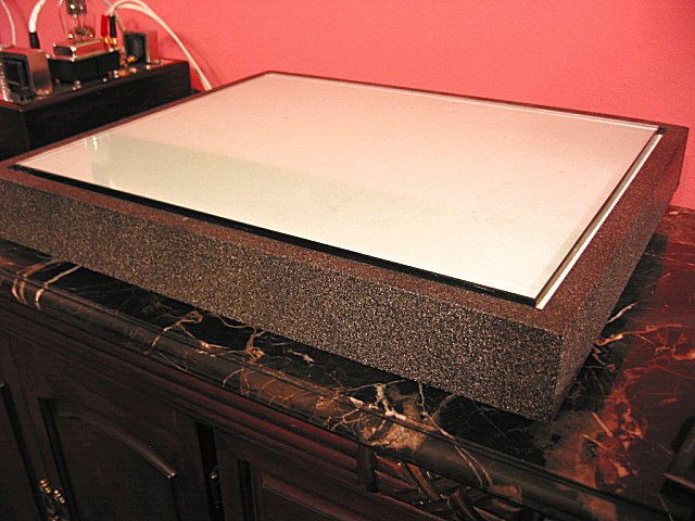

    Good choice as well! One thing I would suggest you look into getting a solid turntable base. Turntables will pick up even the slightest vibration that you can't feel and will transmit this as a signal into your sound system. I've seen many different setups involving heavy sand boxes, lead shot boxes, granite blocks, and concrete blocks. What you basically want is an ultra massive slab underneath the turntable. You WILL notice the difference in sound quality once you properly isolate the system. There's many options open to you and go with whatever you find the most affordable. Shop at a home and garden center if you want the best bang for the buck. Some ideas:
    obin

    Things which are solid will not reduce vibration nearly as effectively as something which is softer. If you care about getting vibration out of your turntable, weight is not nearly as effective as decoupling.

    i just bought a MusicHall USB-1 a few months ago and had tremendous problems with acoustic feedback.i tried many different ways to isolate the unit from my room's sound (bubble pack,pillows,thick blankets) .i even went so far as to build a special wall-shelf unit for the 'table~it was worse than all of my other tweaks combined
    desperate at this point, i ended up mounting it on top of my 46" RPTV's cabinet(not the best placement,i know)--i placed a thick microfiber blanket on top of the tv,then a solid piece of MDF shelving on that.it sits nice and level and solved my turntable's woes,and i've been enjoying my vinyl ever since.
    Obin,what is that black tray with the rubber balls? is that an actual product,or is that some kind of 're-tasked' home center item??
