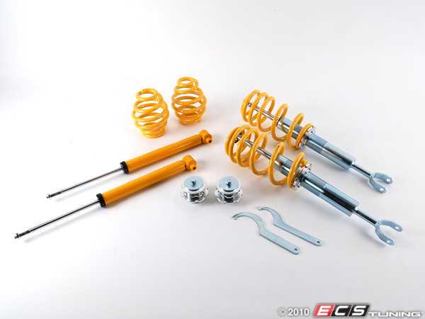

    so ive been wanting to buy the FK street lines can someone tell me whats the difference and whats better to get ? i know the ones from ecs has the fixed damping but not sure about the other ones if they got the fixed damping or not and which one is a better set to buy?
    this one from ecs ...
    http://www.ecstuning.com/Volkswagen-...ine/ES1928131/
    or this one from ESE... whats better ?
    http://www.esetuning.com/FK-Automoti...p/smvw9009.htm

    Those are pretty much identical....
    Nothing in the $500 range will be height and dampening adjustable... only height.

    I think that they are actually the same coils.... but they are certainly height only.
    Depending on the age of your mounts, they should be replaced. They are not expensive, and have to come out during the install anyway, so swapping them is a great idea.
