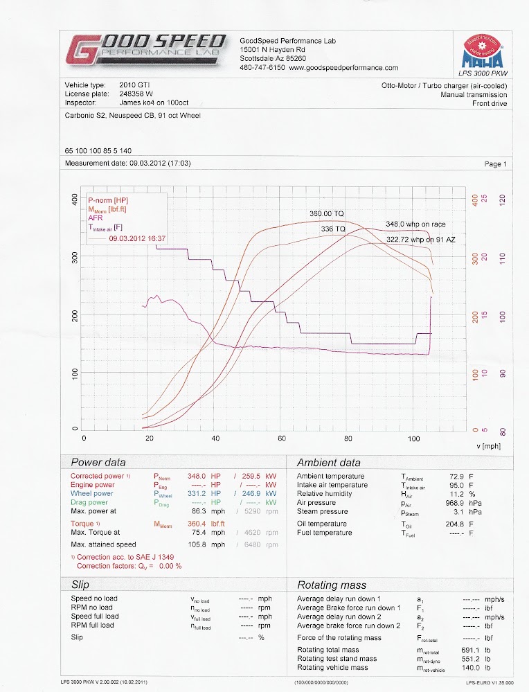

    I was very surprised at the dyno today..... Mods are AWE K04 Kit, Eurojet intercooler, Carbonio S2, APR V2 software, Goodspeed (BB) Catless dp, Neuspeed catback, Corrected WHP was at 348 WHP 360 ftlbs on 100 Oct, 323 WHP 336 ftlbs on 91 Oct. And the DSG seems to be taking it fine.
    CHP Dyno sheet:
    And build Album, install compliments of GoodSpeed in Scottsdale AZ.
    https://picasaweb.google.com/1181514...eat=directlink

    Wow! Very impressive. Your 91 numbers are right in line with APR's official dyno. And your 100 octane runs are screaming! I guess this is how people are trapping almost 120 mph with 100 octane. Just awesome!
    You should post this the engine forum on golfMK6.com as well.

    Great result!!!!!
    But 561.3 Nm that scares me !!!!

    My car is DSG though, they run it in 4th gear. Might be the parts combo, also I have the AWE K04 not the APR K04. My intake setup is the full carbonio S2, my intercooler is the larger eurojet one. My downpipe is the goodspeed Billy Boat catless. Catback is Neuspeed. I am using the Tiguan noise pipe delete. There are quite a few differences in our setup. And lower HP doesn't mean issues.
    here is my WHP sheet if it makes you feel any better:

    nice numbers, only thing is the goodspeed dyno is known for reading numbers EXTREMELY high

    I am sure the other K04 Car that dyno'd 45 WHP less will disagree with you. The MAHA is a pretty stingy dyno. 348 WHP on 100 isnt that far off from what AWE's car made. But I am sure haters are going to hate. I would be happy to dyno on another dyno if you want to pay for it.

    MAHA dyno is pretty damn accurate when setup correctly i have a couple STI/WRX buddies that will dyno at 400 whp at Goodspeed and 340-350 whp at Dyno-comp, Vivid Racing, Forced Air Technologies. Not hating on your car just skeptical with Goodspeed.

    AWHP is completely different than a FWD measurement or a RWD measurement. I can see how they could have drastic results going from a MAHA to a dyno-comp especially if they were loaded wrong at one place. There are more factors to deal with AWD power. Good vid too (But wrx's are not really good from a roll in most scenarios They should be dig racing :p)
