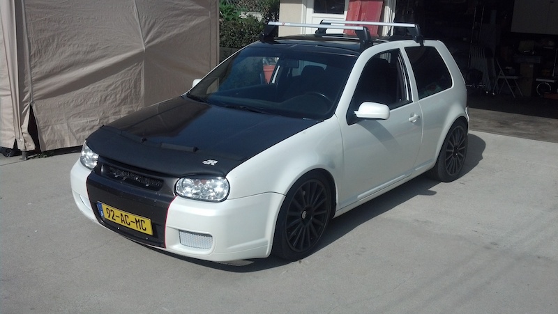

  24. 12-01-2012 12:06 AM #199
    one of my favorites
  25. 12-01-2012 12:08 AM #200
    Quote Originally Posted by nickedtk View Post
    one of my favorites
    cant seem to get the picture to work, but i found this picture of what i believe to be a green 20th (same body kits and rims, sitting next to an IY 20th) tagged ks photography, anyone seen it before ? favorite color for me
