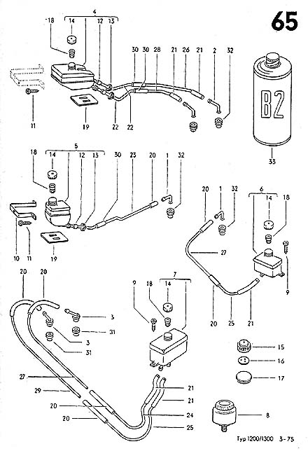

    08-09-2012 03:17 AM #152
    Quote Originally Posted by A1steaksauce View Post
    the unisync is really only good for setting idle. everything else is set by either an a/f meter or by listening to the motor.
    napa here is pretty lame. tiny little stores that never have anything at all in stock. if i'm venturing to a big box parts store it's because i want to have it that day.
    you're lucky. like i said the napa's around here are always slim pickings for whatever i might need...import or domestic.
    oh yes i'm keeping the camper interior. actually if this bay wasn't a camper it would have gotten scrapped.
    i'm tired. so very very tired. anna kendrick could show up naked with whip cream and an evil grin and i'd take a pass...
    but progress...because i don't stop
    first up....
    a nifty little trick i picked up a very long time ago....this is the easiest way to replace the starter bushing.
    take a 12x1.75 tap and with the transmission hooked up to the motor simply start the tap and have a go. eventually the tap will hit the rear of the motor and will start to walk the bushing out...easy peasy:
    and note my 6v starter bushing for a 12v transmission...yes i'm up to no good
    and reason #583 why i need a time machine...
    forking brake res is spaced different between the non-booster master and the boosted master. i so want to go back in time and taint punch the engineer that ok'ed this....because this just funked me big time. no brakes. and no one sells the 69' res aftermarket...and a quick samba search turned up plenty of them on the west coast...but UPS 2 day ship is like almost $60...so i have to decide if i want to man up and spend the coin for that.
    but the day wasn't a total loss....
    i said F U to the brakes and i made her run.
    then i drove her outside to take pics.
    funny story....i'm leaving out the door of the shop and the driveway slopes down into the street...so i'm banking hard to the right to not go into the street and the bus isn't turning for piss. i finally make it over to the side of the shop after a two point turn. my lack of sleep and fried nerves don't pick up on what's causing this right away. well when it finally hits me that my steering arm is out of adjustment i head back into the shop to grab some tools, jack and stands. then i got to thinking, "hey, screw the jack and stands, i've got a fork truck at my disposal and it will easily go under the front of the bus unlike the jack." so i fire up the sucker and head outside to lift up the front end of the bus to adjust the steering linkage. man, let me tell you a fork truck is where it's at for getting under a lowered vehicle. sadly i didn't take any pictures of my little adventure, but i'm sure people driving by got a kick out of it...more so because it took a few ups and downs with the fork truck because i had to keep adjusting the linkage to get it right
    i love this pic:
    you cannot see my motor or transmission. hell it doesn't even look like they're back there
    right now i've got the motor jerry rigged to fire off and run, nothing else. true to hippy bus form all my original wiring is completely fubar'ed and i'm going to have to make a new harness eventually...but right now it's on and off the trailer for the show so jerry rigging is perfectly acceptable
    and i said earlier that i don't stop and always progress...welp, got to thinking about my little res dilemma and i might have a work around for it...got some ideas brewing. if i can get that sorted i'll have brakes and that makes trailer loading and unloading so much easier
    Monday. 5 days to make this all happen.
    steak ,why not just remote the new reservoir you have wherevever you want it to be setting it up kinda like a bug
    using the properly sized elbows?:
    http://www2.cip1.com/SearchResults.a...ch=113-611-810
    http://www.chircoestore.com/catalog/...p?topic=4871.0
    See what I mean?

    i'm not sure i'm going to even run a stock muffler on whatever motor i end up putting in there so you're debating a moot point
    Quote Originally Posted by buggyman View Post
    yea i did think about going that route. and honestly i was going to make that my last ditch resort if i couldn't find a bus reservoir. the only draw back to that setup is i would have to run two lines to the reservoir unlike the bus setup that just uses one. space is already at a premium up underneath there and it would be rather tight to accomplish that.
    thanks to wannabaja i did get sorted and i'm rocking an early bay reservoir setup i do need to source the early bay fill bottle for inside the cabin however...the later bay one i have is designed to sit behind the seat....well i've sort of modded that to the point that it won't work anymore via my tubs so i've got her zip tied to the heater tube inside the cabin for now.

    My bad steak ,I shoulda 'splained better my evil plan:
    Don't install the master reservoir ,just use the elbows Y'd using a barbed fitting like
    close to the master to retain the single feed line from the fill reservoir .
    If your pedal pushrod & brake shoes/pads are adjusted up correctly you should only see ~a 1mm drop of the fluid level in the fill tank between the brakes fully off to mashed down hard + you'd end up with more room to werk with there above the master .
    See where I'm goin' wit dat? .
