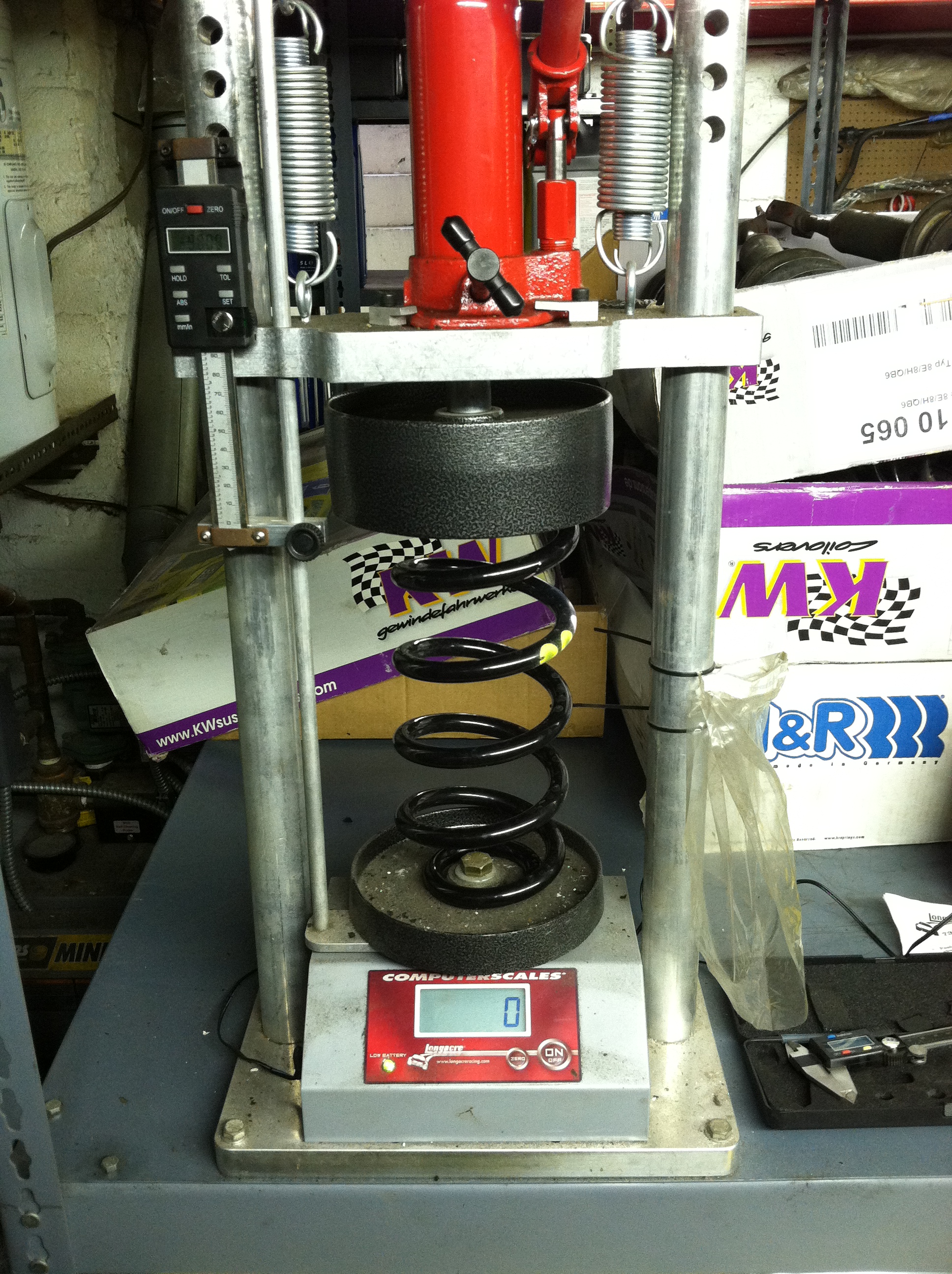

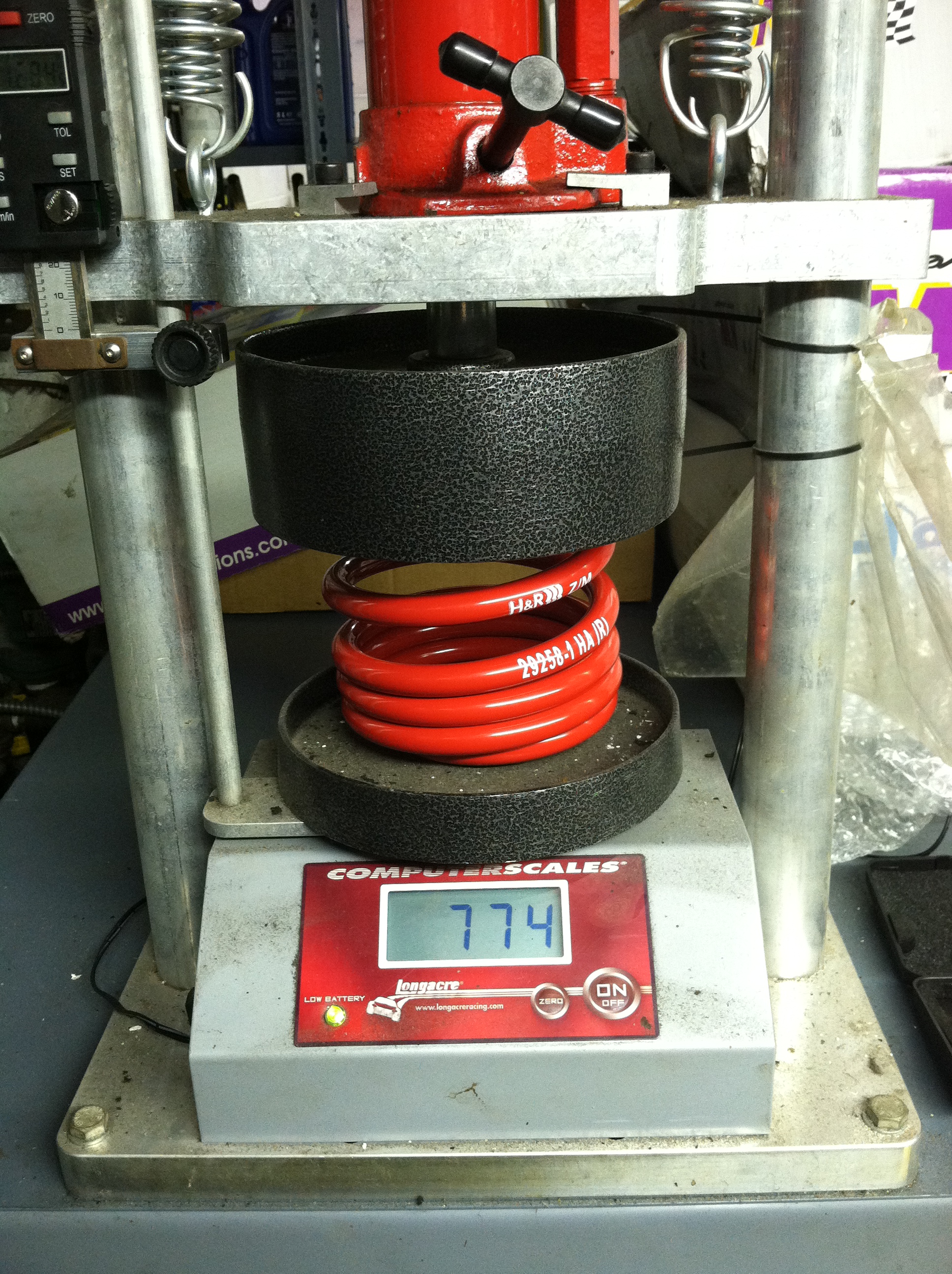

    Spring rate testing has begun!
    First round matchup, Stock vs. H&R Street Coilovers! Let's get ready to ruuuuuuuuuumble!
    Procedure –
    Installed the spring in the rate tester.
    Depress spring 1” to account for install height and reset weight to zero.
    Depress spring to 1” and record reading
    Depress spring to 2” and record reading
    Depress spring to 3” and record reading
    Rates:
    Stock Front:
    1” 195 lb
    2” 390 lb
    3” 575 lb
    H&R front:
    1” 178
    2” 345
    3” 510
    Stock Rear:
    1” 265 lb
    2” 530
    3” 815
    H&R rear:
    1” 150
    2” 320
    3” 540

    Hey my springs are famous.
    Mike and the guys at TyrolSport installed the H&R street coilovers on my R yesterday.
    Also to clarify since there are two sets of H&R street coilovers (along with several other H&R options) for the R these are model #29014-12
    I'm no suspension guru but I do know that the car drives amazing similar to stock yet the spring rates are lower despite the lowering? I thought the rates tend to go up on lowering springs? Or does the dampening stiffness go up and the rate go down to balance out the feel of the ride?
    Whatever the case I'm loving the ride and stance of the R now...thanks Mike!!

    Quote Originally Posted by Tyrol Mike View Post
    Rates:
    Stock Front:
    1” 195 lb
    2” 390 lb
    3” 575 lb
    H&R front:
    1” 178
    2” 345
    3” 510
    Stock Rear:
    1” 265 lb
    2” 530
    3” 815
    H&R rear:
    1” 150
    2” 320
    3” 540
    Mike, are those two door stock springs or four door? They have different part numbers and rates apparently.
    Wow those rear H&R rates are really low compared to stock. That combined with the additional drop would have me worried about riding on, using, or overusing, the bump stops among other things.

    I can't believe how low the spring rates are for the H&R springs. If in the market for springs I definitely would not want the H&R's.

    They're stock 2 door springs.
    I'm driving on these in NY and hit some crazy bumps and dips and crap on the way home from Mike's shop and never once did I bottom out the whole car, hit the bump stops, rub in the wheel wells or bounce around at all. The ride is quite similar to stock. Firm but not jarring and not bouncy at all. I've had MANY lowered cars over the years some were great (337 on KW V1, 2000 Civic Si on Tanabe coilovers) and some drive like bouncy crap (Camaro SS on Eibach springs). This is certainly one of the better feeling setups of all my 9 cars I've owned.
