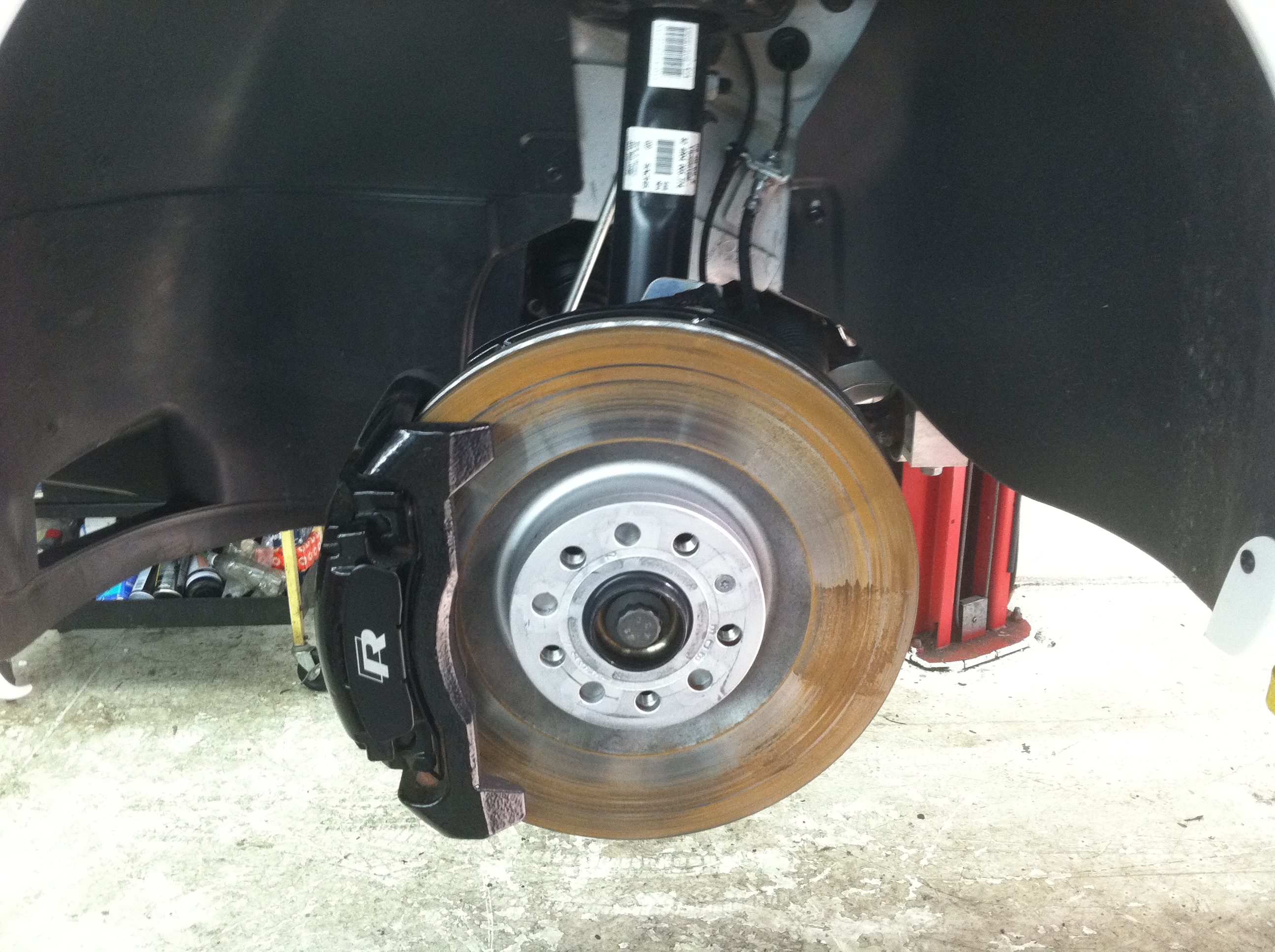

    03-29-2012 06:02 PM #109
    Stock Golf R calipers;

    03-29-2012 07:49 PM #113
    Quote Originally Posted by Tyrol Mike View Post
    No more floating rotors? Did the MK V R32 have one-piece rotors as well?

    03-30-2012 07:42 AM #116
    Quote Originally Posted by speedbump2 View Post
    This Mk IV R32 is spoiling me. I'm really going to miss it when my Golf R finally gets here.
    --Chuck--
    Mk4 R32 had semi-floaters, Mk5 R32 and Mk6 R do not.

    03-30-2012 11:09 AM #121
    Quote Originally Posted by CnSR32 View Post
    Almost positive the calipers from the MKV R32 and Golf R had the same part number, I'll see if I can track down the info.
    Great read though and a lot of good info coming in!!!!
    The Golf R front calipers are slightly different from the MKV R32's.
