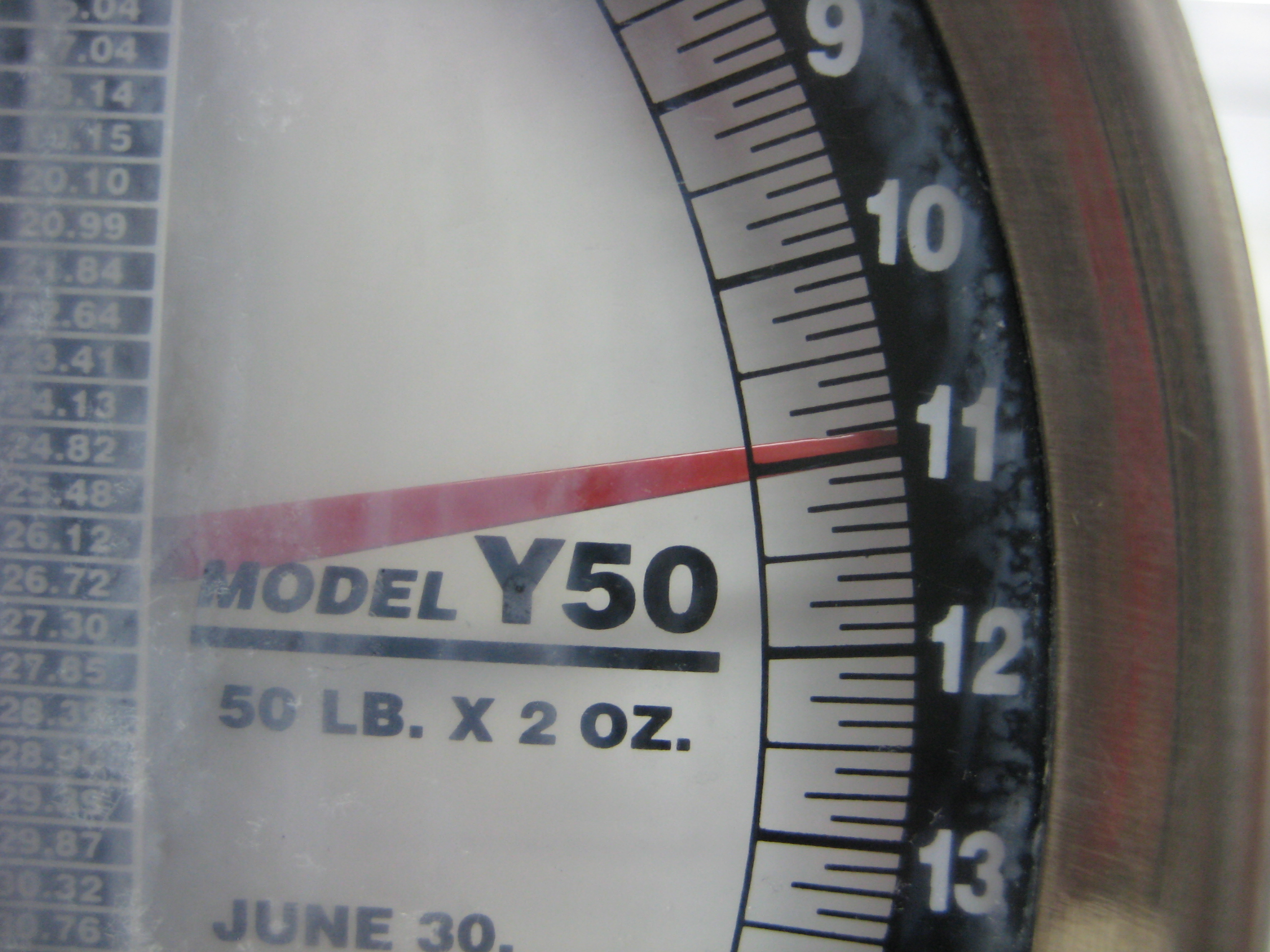

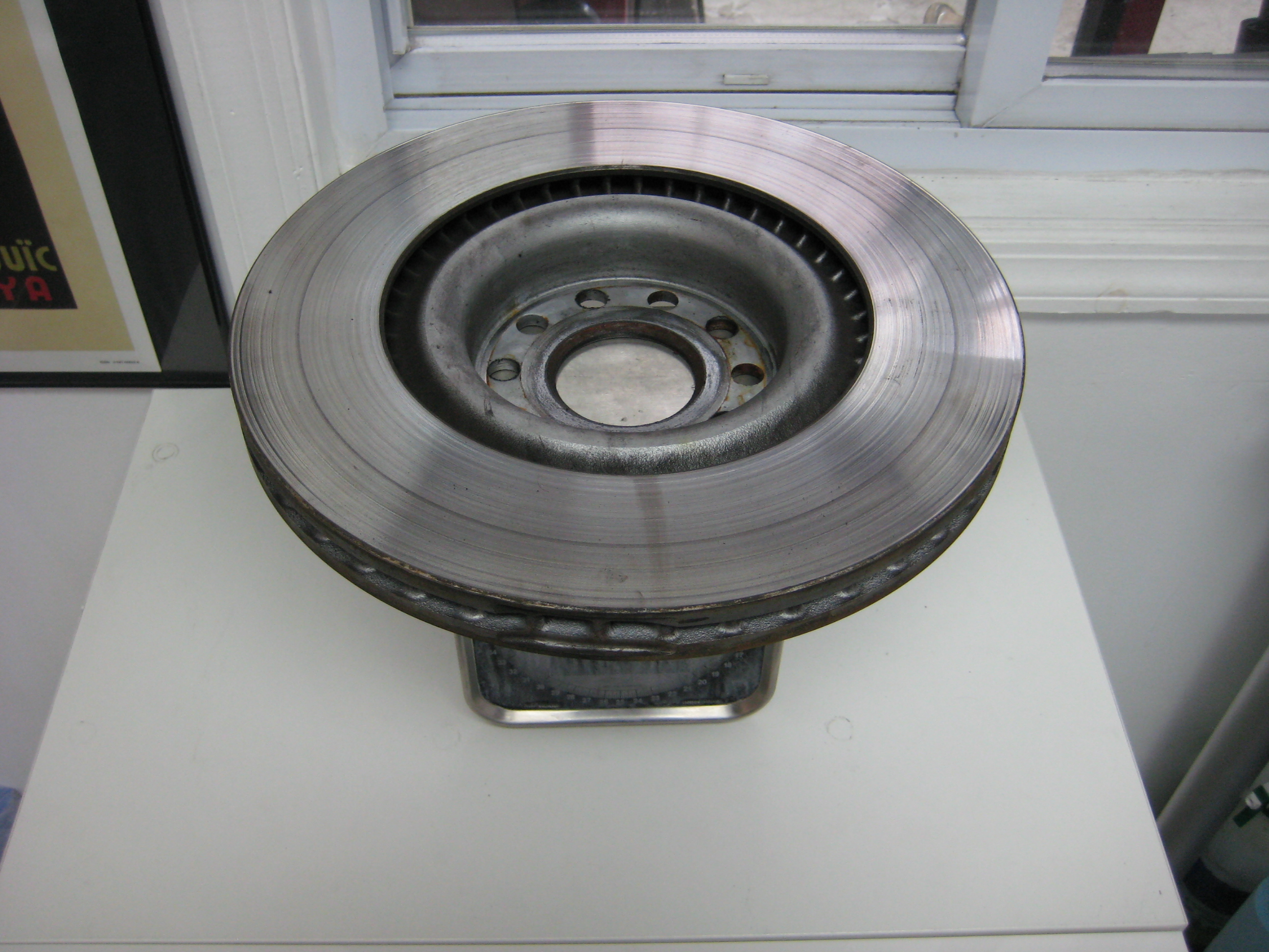

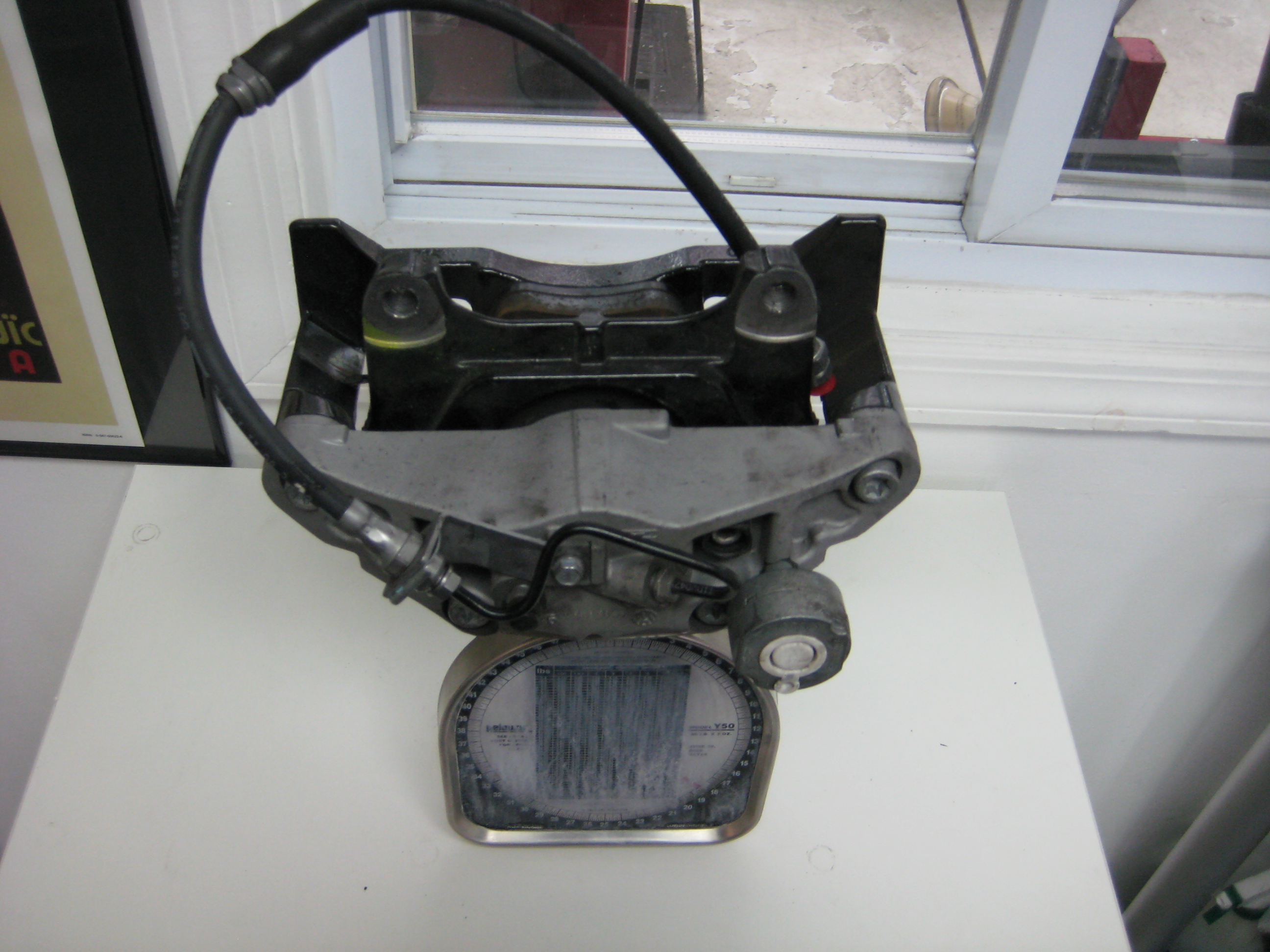

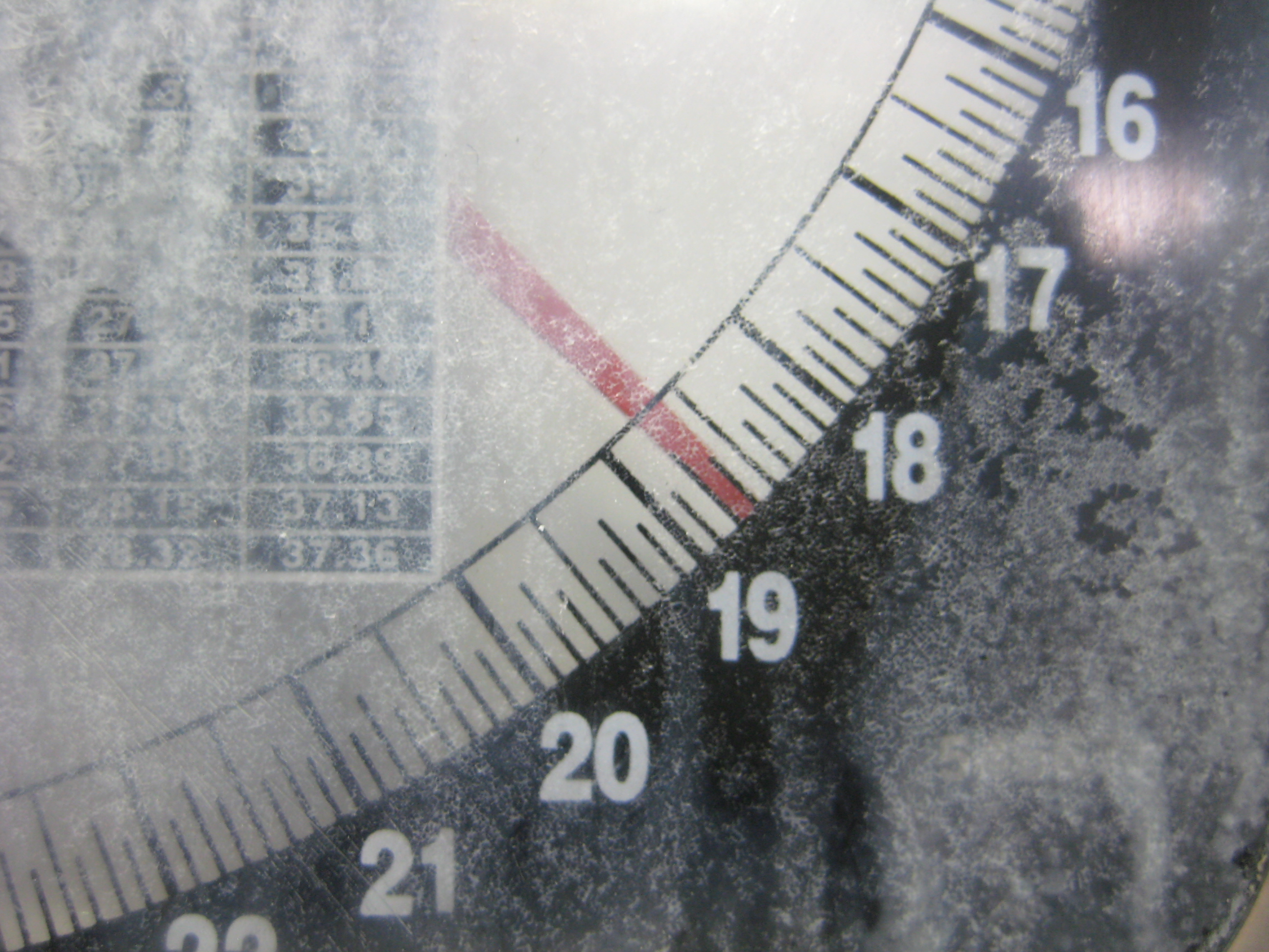

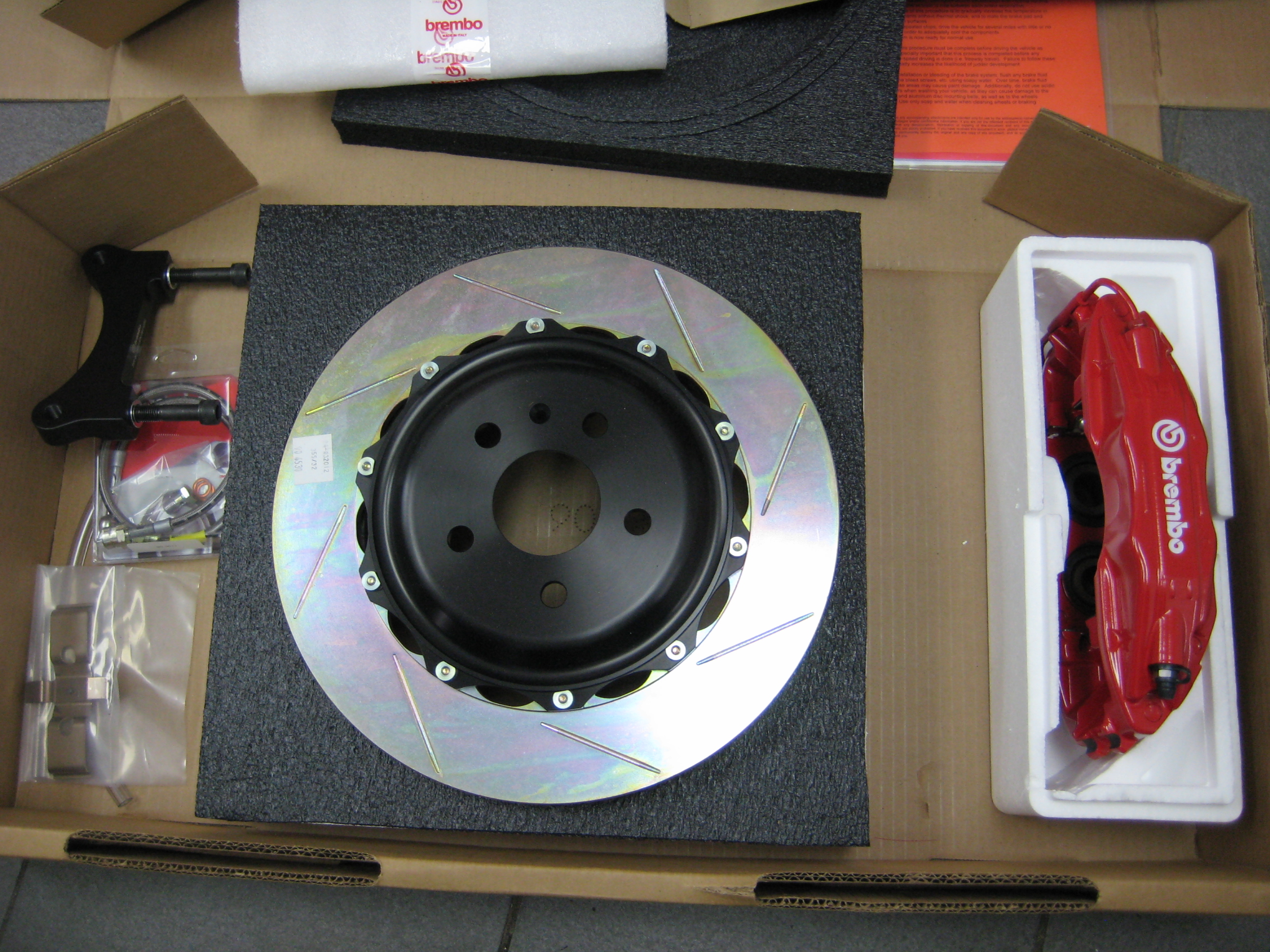

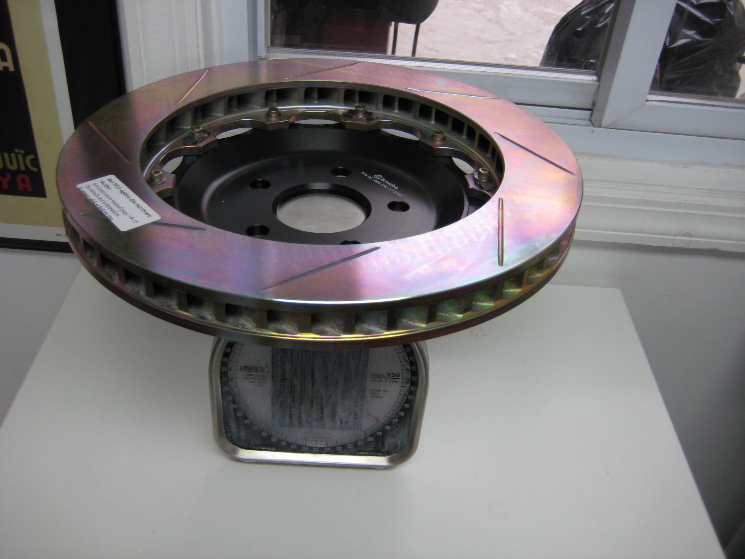

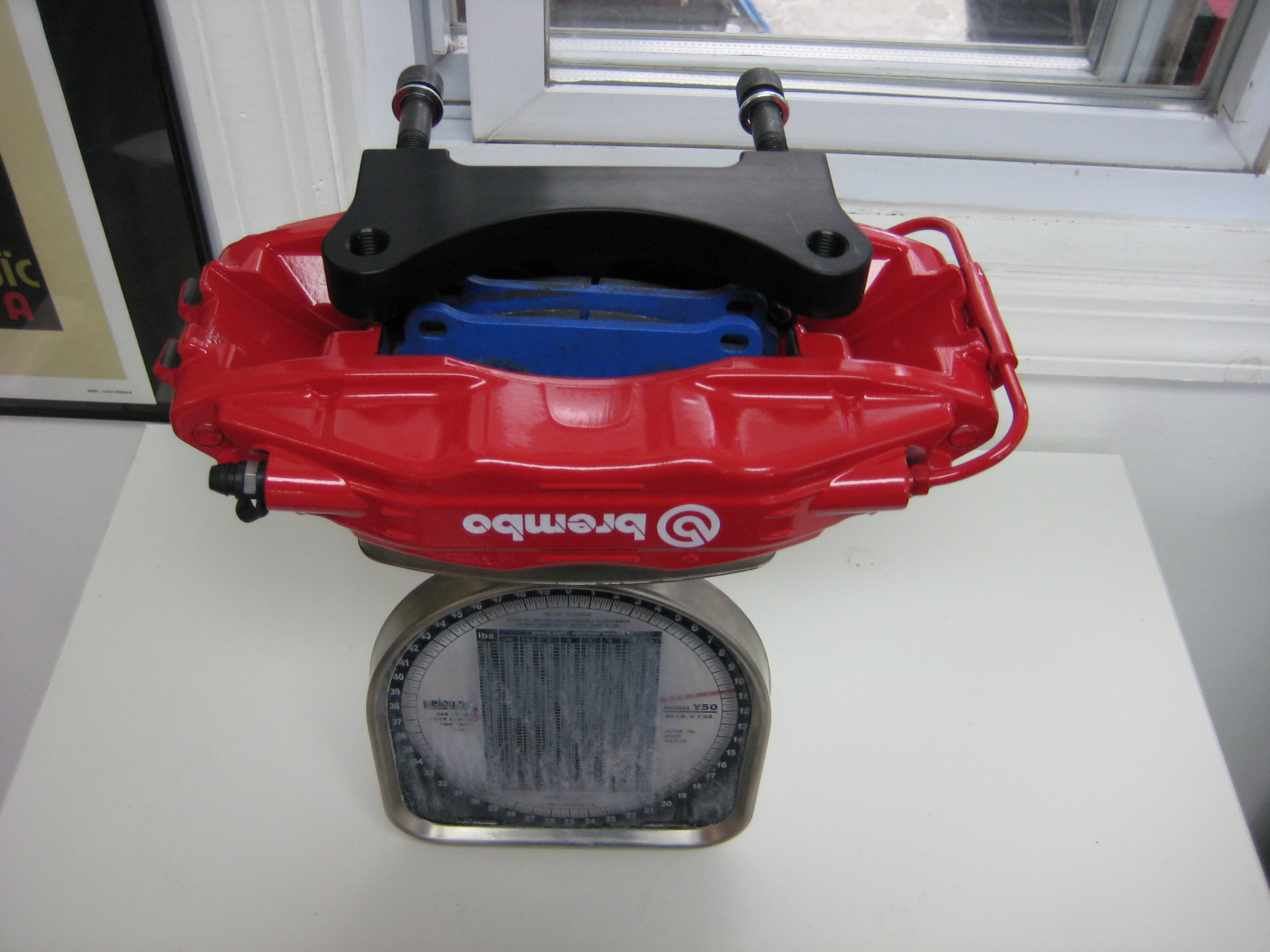

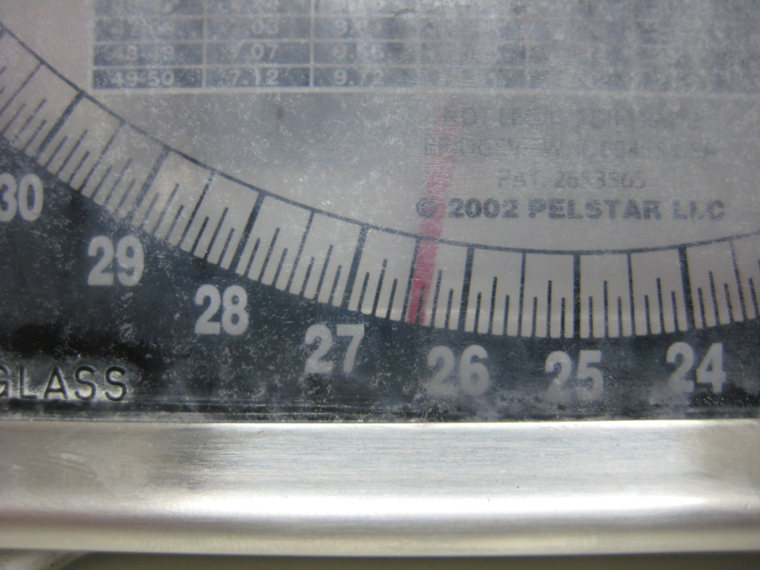

    Time for some brake weight pron;
    I went with a Brembo kit for a number of reasons; quality, performance, pad availability, and product support. There are a number of kits available from Brembo that will fit the GolfR. There is a 6 piston/350mm disk, a 4 piston 355mm, and a 4 piston 365mm. The price and performance rating go down as the rotor size goes up(Yes, I know that sounds odd). Basically, the smaller rotors are denser and in some cases have more race oriented hardware.
    I chose the 355 kit for a number of reasons; wheel fitment(stock 18s will fit with 10mm spacers), pad selection(one of the most common pad outlines), ability to swap pads without removing the calipers, and the fact that I already had a bunch of pads here that I could use. If anyone needs help selecting the right kit for their car, just PM me, as I did a TON of research before making a decision. For those guys looking for the ultimate in weight savings, you can even consider downsizing to a 332 kit which will probably have more braking power than stock, weigh probably 20lbs less per corner, and will fit 17s.
    Anyway on to the Brembo weights;
    Total weight savings over stock per corner: 15.75lbs!
    Are you listening Gilligan?
    Remember though, any time you take weight out of the rotor, you have less mass to absorb heat, so there is a balance when choosing the size and type of rotor. Brembo offers many different rotor ring designs in terms of fin design, density, etc. so make sure you do your homework before upgrading your brakes!

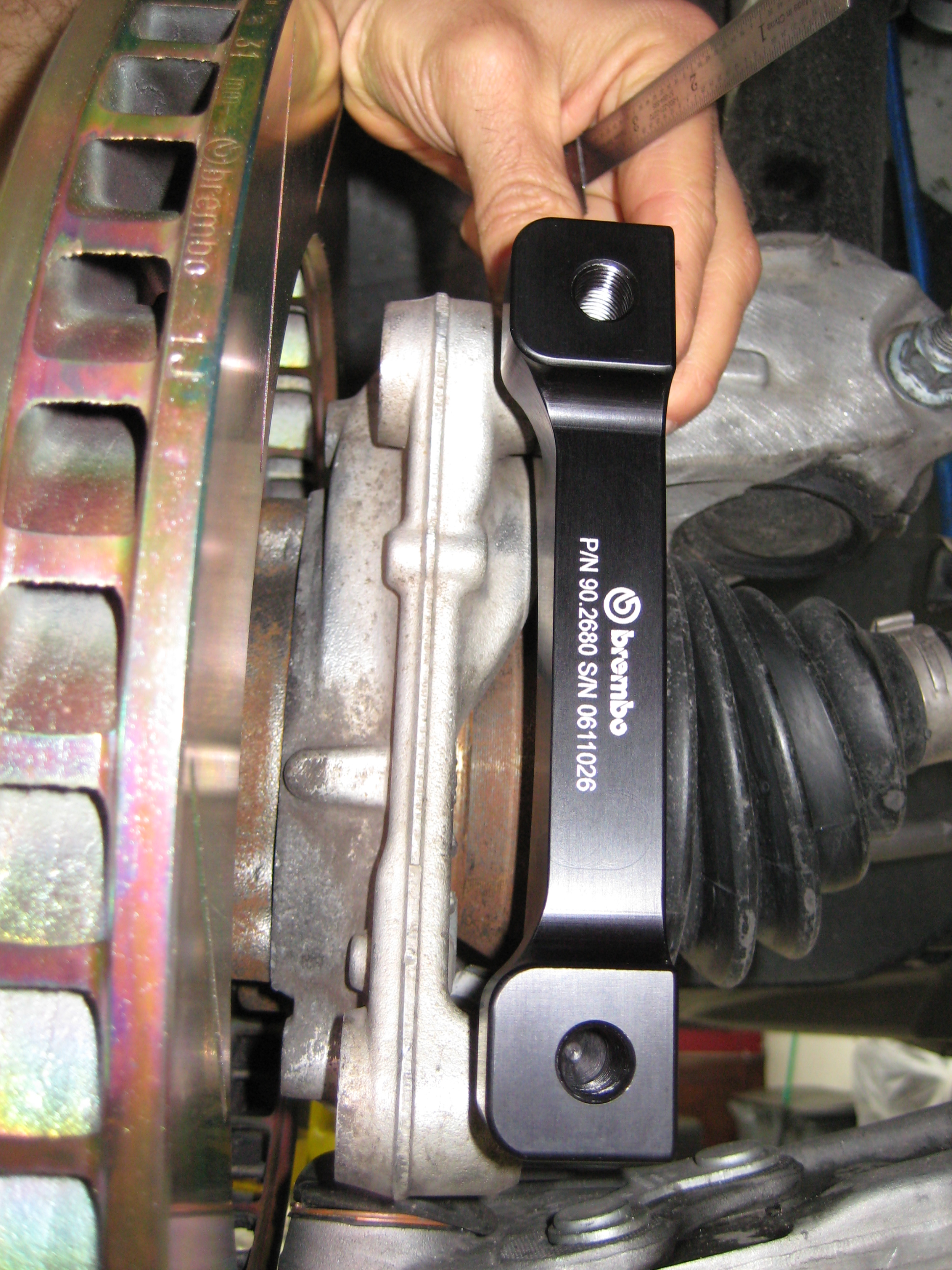

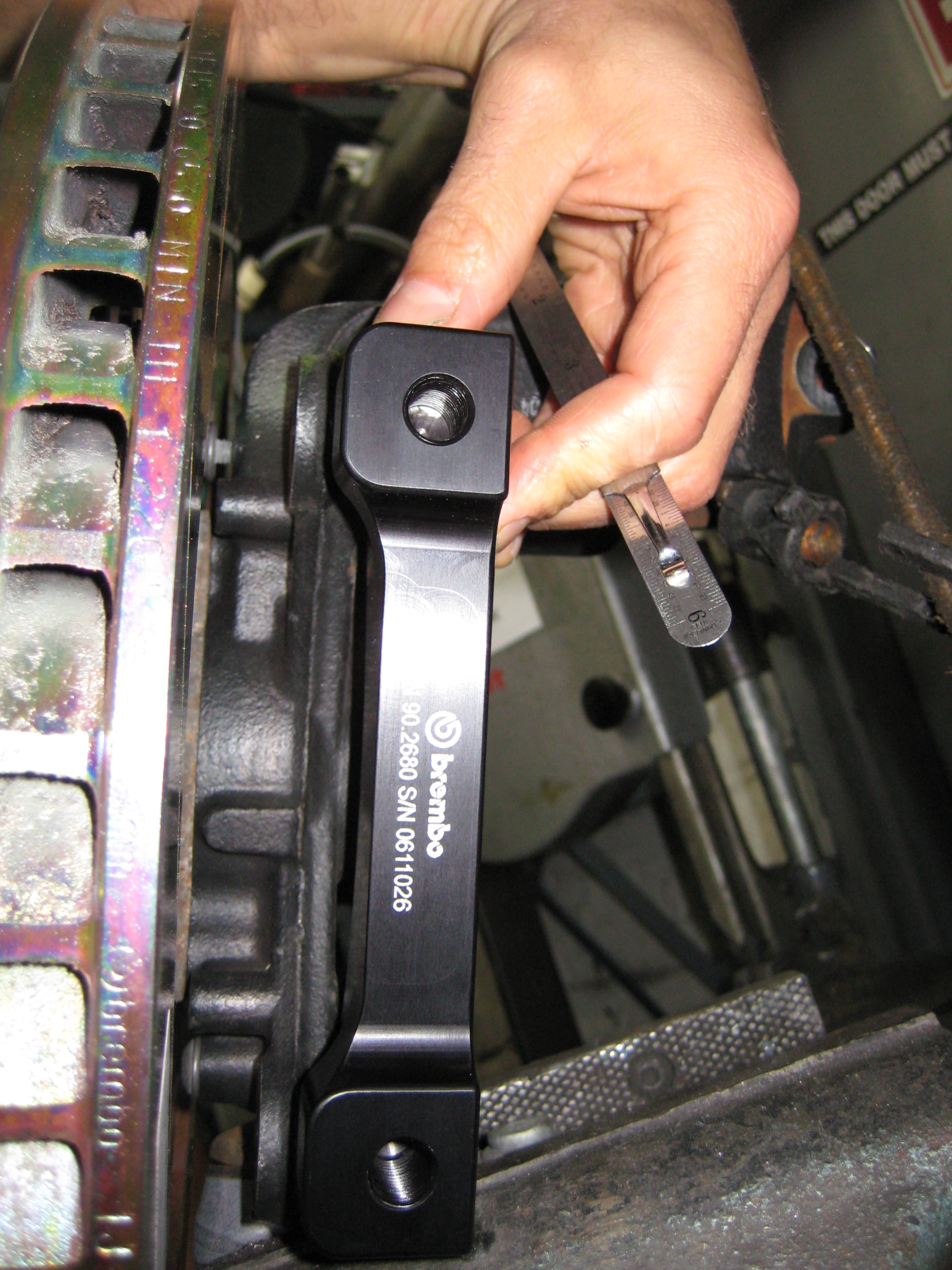

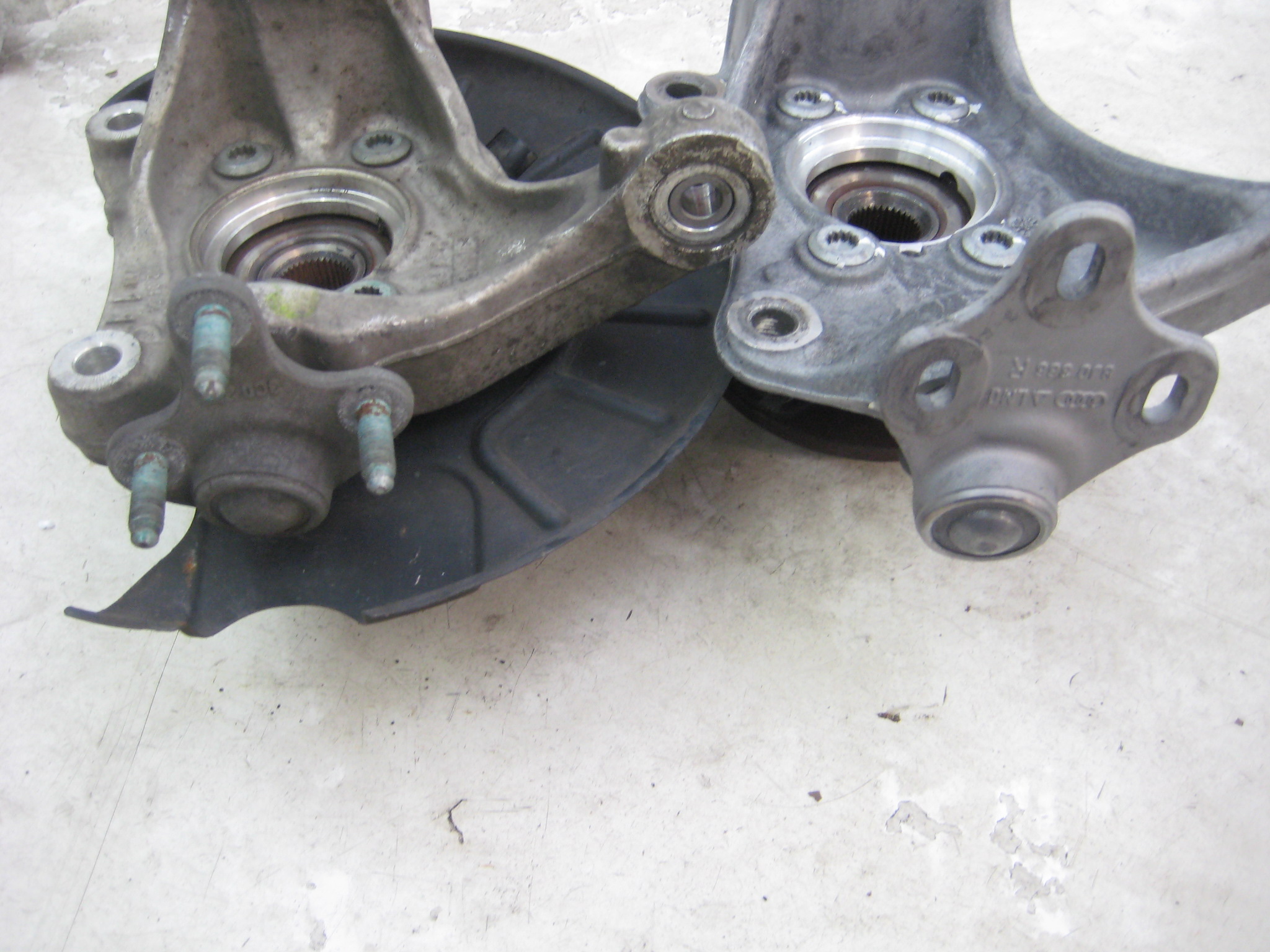

    And here is why if you run Passat spindles, brake kits designed for the GTI/GolfR OEMspindles won't fit;
    The OEM spindles and thinner mounting bosses:
    The passat spindles are about 13mm thicker, which pulls the caliper too far inboard:
    In order for the Passat spindles to work, they must be machined properly. Thankfully I have access to everything needed to do this, so it did not become a fiasco.
    And before anyone says that this may be dangerous, take a look at the thickness of the TT spindle (shown earlier in this thread), where the caliper carrier mounts:
    The TT alu spindle has the same thickness as the OEM cast iron spindle.
