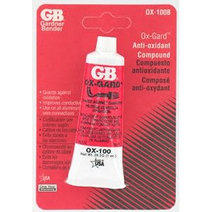

    I cleaned up my alternator. Removed the voltage regulator, put ox guard on the copper to aluminum junctions, polished all the corrosion off surfaces and brushed the corrosion off the voltage regulator heat sinks. The alternator wire is still suspect and likely getting replaced tonight as it's original and there is enough corrosion at the battery end and I just don't like the factory ends. Much less in the way of lights dimming if you cruise and roll a couple windows down.

    Could you post a link to the oxidation guard you're using?

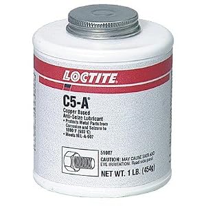

    04-09-2012 12:32 PM #39
    Quote Originally Posted by groggory View Post
    2k copper anti seize on heavy spots, and ox-guard brand zinc paste on aluminum. Ox guard specifically says it is for dissimilar metals and aluminum junctions.
    Your voltage regulator has a nice copper u shaped connector that goes to aluminum with no corrosion guard, and another copper to aluminum junction. You'll see it all when you take it apart, bosch and dissimilar metals being used in key places, like peanut butter and jelly. Expect nothing less.
    White fuzz/corrosion and black tarnish/corrosion. Break out the dremel, wire wheel attachment and 400 grit sandpaper.
    This stuff is basically all colloidial copper.

    04-09-2012 08:25 PM #40
    why dont you use dielectric grease... I would never put copper paste on a metal to metal electrical connection.

    04-10-2012 05:23 AM #41
    Dielectric grease will fill the gaps between the contact surfaces and prevent oxidation, but its main virtue is that it's a high-voltage insulator (great for spark plug boots, for example). The stuff that gdoggmoney suggests should actually help make better conductivity between the conductor surfaces in addition to the protective qualities, but you would generally want to keep it off of non-conductive surfaces.

    04-10-2012 03:58 PM #42
    Quote Originally Posted by BassNotes View Post
    Thanks. You said what I would have.
    Your moving 100+amps through that cable, and through these dissimilar metals. increasing the surface area by using zinc impregnated grease or colloidial copper anti seize will actually do just that -- increase the surface area and promote a cooler connection.
    Heat = resistance = voltage drop etc. etc. etc.

    04-11-2012 08:17 PM #43
    never had an issue with dielectric grease.
    I put it on battery terminals, starter terminals, and alternator terminals when I disconnect them. Only thing is it heats up and evaporates so you have to re-apply it every year or so.

    04-11-2012 11:57 PM #45
    Most 1.8T alternators I've seen are 120A (including mine).
    Most of the time, of course, after the initial re-charging of the battery after a start, the current demand will be under 30 to 40A even with the headlights, fog lights, and a lot of accessories turned on.
    I wouldn't waste dielectric grease on battery posts, alternator connections, etc. Sure, it will work, but for preventing oxidation and keeping moisture out between surfaces so will lithium grease at a fraction of the cost. I like gdoggmoney's suggestions for high-current connections, especially those whose quality can be problematic, but I've also used lithium grease in those situations to good protective effect, even if it doesn't enhance the conduction.

    04-12-2012 10:50 PM #49
    The ox guard appears to be non conductive.
    However, I believe in its merits as an oxidation inhibitor.
    I don't believe it will improve on the conductivity of bare metal to bare metal
    I do believe it will NOT reduce conductivity
    I do believe it will improve long term conductivity
