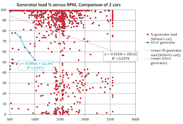

    I’m often wondering whether I’m the only guy on the forum who owns a Phaeton with the dash panel voltmeter sitting between 13.5 and 14 Volt, instead of a rock solid 14 Volts.
    It would be fantastic if some members could provide some feedback of what they are measuring with their VCDS.
    The generator performance can be monitored by entering controller 01 (Engine Electronics), then by entering MVB (measuring blocks). Then type 053 in Group A. This will produce the readings of 4 measurements:
    Field 1: Engine RPM actual
    Field 2: Engine RPM desired
    Field 3: Battery Voltage as seen by the Engine ECM
    Field 4: Generator power in % (0 to 100)
    The latter is the DF value (dynamo field), a value which is reported by the alternator to the J519 module and the ECM. It is the result of the generator's built-in regulator, which controls the power (voltage) output of the generator by means of adjusting the dynamo field current.
    It would be very interesting to know what values other forum member are getting for battery voltage and generator power, when RPM is at idle speed (550 RPM), slightly higher RPM (i.e.700 RPM) and at 1500 RPM.
    Today I measured these values with VCDS and noticed that the % generator load is constantly sitting at 99.2% at 550 RPM, regardless of consumers. The battery voltage never exceeded 13.58 Volts, even though I shut down every possible power consumer (including the rear heater – via the A/C menu –> extra functions). With electrical consumers, the voltage drops a bit, then slowly recovers to the original 13.58 (except at idle RPM).
    The battery voltage stays above 13 Volt most of the time, but occasionally drops down to 12.6 Volts. Increasing engine RPM, does affect the generator load value, but it looks very unstable, sometimes jumping to 0 and anything between 0 and 100.
    I made a log file (via the same menu in VCDS) and after I’m done with that, I will post the trends. Meanwhile, I’m anxious to hear what values other members are measuring…Perhaps
    what I am seeing is normal behaviour and there is nothing to worry about.

    Here's the data on the V10, in case it's similar to the W12. I can't think why it should be designed differently, except for the idle speed.
    Car: standing for 20 hours, ambient 10 degC.
    Batteries: both new 2 weeks ago.
    -- Open car doors for 10 mins.
    -- Start VCDS in Controller 01, Group 53 [not available]
    -- Turn on car (not engine). Dash voltmeter reads 11.8V rising to 12.75V over 30 secs
    -- Start engine. Dash voltmeter drops to 11.6V for 5 secs, then rises immediately to 14.1V
    -- Change VCDS to Group 16 [Reading available]
    -- Revs 609 - Load 78% - 13.6V
    -- Revs 714 - Load 74% - 13.6V
    -- Revs 800 - Load 64% - 13.6V
    -- Revs 1000 - Load 52% - 13.6V
    -- NB - Group 16 volts drop from 13.6V to 13.53V for 2 secs whenever engine speed is changed
    -- Dash voltmeter reads 14.1V throughout, other than as noted above.
    Sorry I missed the initial VCDS volts, the V10 ECU has the battery data on a different Group from the W12 and it took me a few seconds to figure this out. Its alternator Group 16 did not show me desired idle speed, only actual.
    Chris

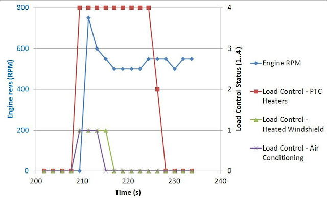

    This is an interesting point. I made oscilloscope screenshots (also possible with VCDS) of the voltage of both batteries. I will post the results in a next post. It is amazing to see how quickly the starter battery recovers its original voltage (almost 15 Volts). But, the consumed energy during starting is not so much though. 300 amps, during 1 second, it is just 0.1 Ah...

    Hi Chris,
    Thank you for your data. This is very useful information! And wow, that is what I would call a good charging system! Your % load reading (coming from DFM – Dynamo Field Monitor) at least decreases in a logical way. It is inversely proportional to the revs (makes perfect sense). Even though your dash meter shows 14.1 Volt, the reported 13.6 Volt looks like a good charging voltage. Mine doesn’t do that at all.
    Willem

    That isn't number of times ILM happened. It's the deepest stage of ILM your Phaeton has encountered since the last reset of the ILM value. Your car could have been under ILM a thousand times but only gotten to stage three each time, and that value would still be three. Stage 14 means it ran through everything it's got, which should be just about impossible with the engine running but is very possible with the engine shut off and the battery running down.
    Unfortunately, it's hard to get solid documentation on ILM. There's some good basic info in the self-study guides. There's more detailed information in a TSB Volkswagen put out a while back, but it partially conflicts with the self-study guides and only shows 12 of the 14 stages. I studied this stuff in detail when I was documenting the Climatronic response to ILM.
    These are my notes from a few months ago, showing what I think are the real ILM stages. It's the 12-item priority list from the TSB, with two missing items inserted based on the VW SSP at #2 and #6.
    1 - PTC reduce 25%
    2 - from SSP, seat heating to 50%
    3 - Rear defrost reduce 50%
    4 - PTC reduce 50%
    5 - Heated seats and ventilation off
    6 - from SSP, heated windshield off
    7 - PTC reduce 75%
    8 - Wiper park position and washer nozzle heating off
    9 - Side mirror heating
    10 - PTC reduce 100%
    11 - Heated steering wheel off
    12 - Rear defrost off
    13 - HVAC fan 30% reduction
    14 - Compressor shutoff
    I believe the instrument cluster "consumers being shut off" warning happens somewhere around stage 12 or 13. Central Electronics is bad about giving you live ILM state, I think it only gives you ON/OFF and the deepest state ever reached since reset. But, you can get a pretty good sense by watching Climatronic MVB 043. Columns are PTC heating, windshield heating, unknown/irrelevant and HVAC fan/compressor respectively.
    0 0 - 0 ILM not currently active
    1 0 - 0 ILM stage 1
    2 0 - 0 ILM stage 4
    2 1 - 0 ILM stage 6
    3 1 - 0 ILM stage 7
    4 1 - 0 ILM stage 10
    4 1 - 1 ILM stage 13
    4 1 - 2 ILM stage 14
    You'll see the car go through the above sequence, in order, if you sit in the car and let the battery run down somewhat. Then if you clip on your battery charger, you can actually watch it slowly roll back up the ILM priority list as system voltage is restored to normal levels.

    Hi Mike,
    You sure are getting the hang of it! Those are nice trends, similar to mine. The generator produces 13.3 Volts, which seems a bit low. Perhaps VW DID intentionally install a dash panel meter that reads 14 Volts when there is nothing to worry about, and only fluctuates when there are big deviations from the ideal situation. Then I will have something to worry about.
    Your log file probably also contains the data of the DFM, is you used MVB of the engine control module. When you send me the log file, I will merge your information in one trend, so that the difference between our cars and generators becomes more easy to see. I will send you a PM.
    Willem

    Here are some first trends, based on the data of the log file during a 10 minute test drive.
    The first trend below shows the battery voltage & load% (Dynamo Field value) versus time. I drove the car as usual, so the RPM was normally above idle.
    During the first 250 seconds I, all electrical consumers were switched off (A/C off as well). Then, from 250 to 400 seconds, the A/C was on. From 400 to 550 seconds, I switched on the rear wind shield heater, dipped beam and the fog lights. And after 550 seconds, I switched all off except for the A/C.
    As you can see, there is no clear relationship between the actual load (the consumers) and the generator load% as reported by VCDS. It is easy to see though, that with everything switched on, the generator has a hard time to keep the voltage above 12.5 Volts.
    The below trend shows the "relationship" between battery voltage and load%. All red squares are individual measurements of the VCDS of my car. The blue dots represent the data of Chris' car.
    As you can see, my own measurements are virtually random. There is no logical relationship between generator load and RPM.
    When you look at the blue dots (data reported by Chris), you can see that there is a good relationship between RPM and load%.
    The higher the RPM of the engine, the higher the RPM of the generator and the higher the voltage output (when the DFM is not adjusted). This principle is similar to that of a bicycle dynamo; the faster it rotates, the more voltage it generates.
    In a car's electrical system, this effect is compensated by regulating the field strength of the rotor poles. This is done by the regulator, which is integrated the generator and is not controlled by any control module at all. Therefore, I would expect that the reported generator load % (which is basically the field current or DFM) would drop with increasing RPM. This makes me think that the generator is not working as it should, or at least not when there is a high electrical demand.
    Willem

    Hi Willem,
    Very useful presentation of your data.
    Sorry I can't replicate your 10-min drive right now, my laptop battery is shot and I have to use mains power, and the other one is a Mac. Plugging in a 10amp 12V DC-AC converter would distort the figures!
    I am sure you posted when you fitted new batteries, but I can't remember.
    The random distribution of those outlier load % figures looks very unhappy. Unless it's something to do with the small reduction in power supply voltage every time the engine revs change, which they do frequently on a normal drive, naturally. Perhaps the alternator's voltage regulator drops the volts or puts in a response time delay when it sees an output fluctuation, so as not to ever run over-volts. Or the ECU too busy to bother to report on Group 53.
    Other than that, it does look as if the alternator is not delivering power predictably, or else the % load reporting wire from the alternator is loose!
    Is there any noise on the AM radio?
    Chris

    Hi Chris and Mike,
    You both seem to have a V10. The topology of the groups of the ECM is apparently not identical to that of the W12, also as far as the group 053 is concerned. Chris already mentioned that he found “load %” in group 016, however I overlooked that information initially. Mike made a log file with group 016 of which I now made a trend versus RPM. It is very likely that Group 016 (Controller 01 of V10) is in fact the generator load%. Perhaps the label file of the V10 engine can confirm this, but it doesn’t seem to exist in my VCDS or I erased it. (Label file for controller 070 906 016 B).
    The trend below shows how the load % responds to the RPM of the engine. As you can see, it is quite different than my own W12. It is much more stable and the variations can be directly related to RPM. Another factor is the electrical power consumption during the ride, which is of course depending on many factors. Everything in the car uses electricity, i.e. gear shifts, A/C, rear PTC heater etc. So it is only natural that the load % is not only inversely proportional to the RPM of the engine.
    My conclusion is that both alternators are working fine.

    I made a log file using Climatronic MVB 043. The result is given below:
    Only during a very short period of time, during the start procedure, some power consumers are shut down.
    The status of the MVB 043 is illustrated in below picture:
    To me, it looks logical that these power consumers are shut down during cranking the engine and up to 5 seconds thereafter, because the ECM consumes quite a bit of energy. I stopped the car for some time (from 700 up to 1350 seconds in the first trend), and then started the car again with the same result.
    My problem is actually not that the engine shuts down electrical consumers while driving. During the winter time, I used the auxiliary heater every day, for about 10 to 15 minutes per day. When I charge the battery with an external charger, I can use the heater about 5 times per week. The 6th time, it will not turn on. When I make a scan, these errors are reported:

    Half a year ago, I went to the dealer and one of the things I asked, was to check the state of the battery. After completion of this test, which I was allowed to witness, the technician gave me a little printout of the result. This report told me that the test apparently was done using a Midtronics device, Inpect 65, version 11 @2005, with the following details:
    • Charge conditions: 12.21 Volt
    • Measured: 798A (SAE)
    • Value: 520A (SAE).
    Below this text, to graph bars telling me that the battery condition was 100% (798A is a lot better than the specified 520A !) and charge condition 40%. Conclusion: battery is excellent, but needs recharging. A remarkable result, given that I had just been recharging my battery 2 days before. And it was in the middle of the summer, so there couldn’t have been much battery drain due to “cold weather” electricity consumers, like defrosters, PTC rear heaters and so on.
    I also checked the battery drain using a current clamp. No more than 35 mA each time, although it can take up to 10 minutes before this quiescent current is reached.
    This is why I suspect my generator...and hope to find an easy way to use VCDS in diagnosing the cause of the problem. Which is apparently not so easy.
    Willem

    Don't worry, you probably are not the only one... I just hope that we can find a quick and easy method and standards to determine the condition of the generator and the battery.
    MVB 053/3 in the engine controller of my W12 remained pretty constant at 13.2 volts regardless of engine RPM (RPM range was 550 to 1,000).
    MVB 053/4 appeared to be fixed at 99.2% when the engine was idling. When I increased the engine speed above about 700 RPM (range between 700 RPM and 1,000 RPM), the reading flickered rapidly between 99.2 and single digits, with 99.2% predominating.
    That is about the same as what Jason observed (I'll post some trends later).
    By way of comparison, MVB group 007 of controller 09 (the central electrical controller) showed a pretty constant 13.7V for the left battery and 14.65V for the right battery, regardless of RPM.
    That looks OK to me. I'm trying to figure out where all these voltage readings are coming from. It is possible that the Central Electrical Controller (06) and the ECM have their own voltmeter built-in, to report eventual problems. Some difference in voltage reading can be expected then.

    Quote Originally Posted by jyoung8607 View Post
    .... I often see ILM actively managing stuff like the defroster. This would be invisible to the driver unless ....
    Thanks Jason, I didn't know this.

    Willem, I emailed you some VCDS logs from my car. You already have the Excel charts built the way you want, so I'll let you integrate and compare the data however you like.
    I'm working on them right now!
    I think we are all seeing the same generator-DF oscillating values.
    All 3 W12's have pretty much identical oscillations.
    Is it possible the reading we're being shown is an instantaneous sample of a PWM control signal? It would account for "random" values being shown when less-than-full output is called for.
    It is possible that the ECM can't make any soup (Dutch expression) of this PWM signal, while the PWM control signal itself might look perfect. (when viewed with an oscilloscope). I just have no possibility to reach the DFM right now.
