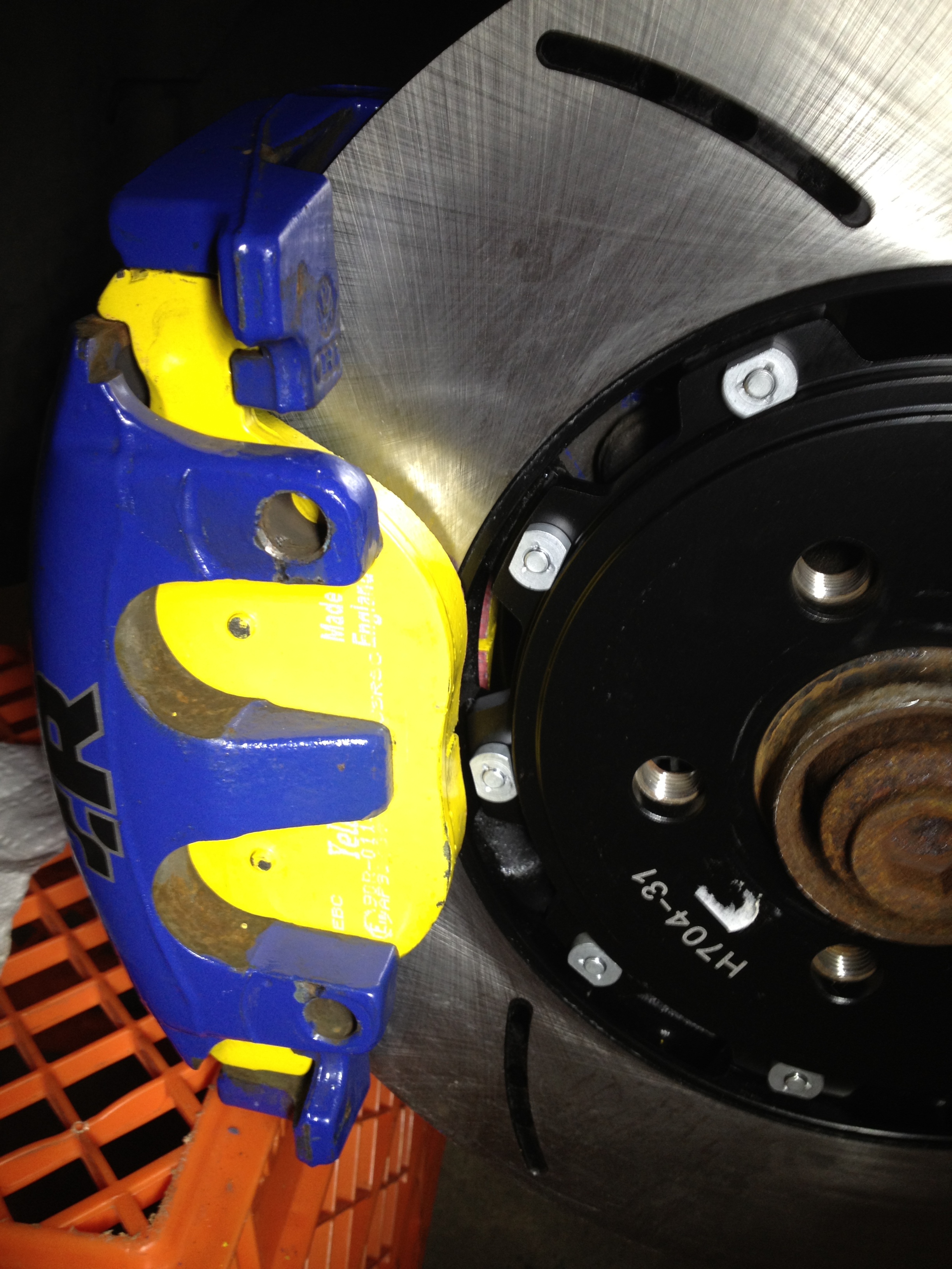

    Better than drilled.
    http://automobiledayspa.storenvy.com...-tt-front-2004

    mmmm looking at the picture below you lose alot of pad to disc!.....They have reduced the price? lol what? because someone cannot use a ruler and calculator?

    nkgneto, whoa~that's too rich for me,man they are listed as being sold out,anyway.they do look pretty awesome though.
    Quote Originally Posted by Slapbladder View Post
    i've seen this type of thing before.i'm not certain if it's an error,or they make the disc slightly smaller so that the pads can sweep the entire disc.when worn--you don't get that 'lip' on the bottom and top of the disc like on the stock ones.

    The disc to pad running like that is not right.....a lip on the disc shows that the full pad is incontact with the disc at all times....
    Just make sure the parts you are buying look like this and the part numbers match...
