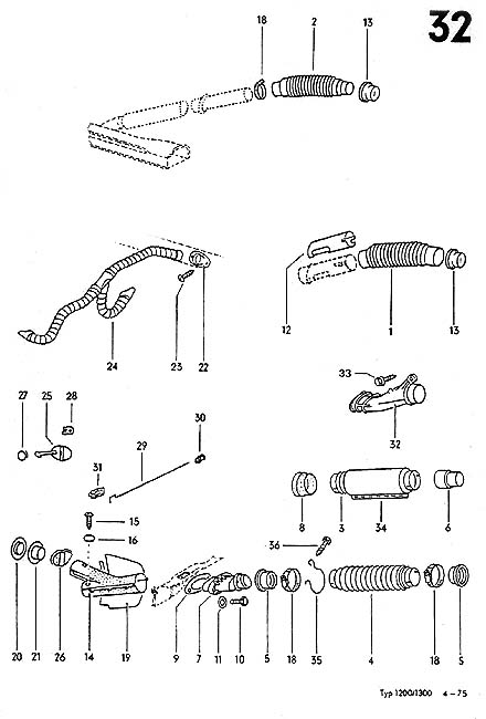

    Ok, I installed J Tubes, welded my fan shroud ducts shut, and sealed my tin where the hoses went through. What do I use to seal/cover the hoses that go to the cabin?
    An appropriately sized freeze or expansion plug

  14. Member 6603's Avatar
    Aug 25th, 2004
    Anaheim, CA
    2,913
    03 Jetta 64 Beetle
    05-05-2012 11:21 PM #14
    Thanks buggyman. I have never used freeze plugs. Do I just tap them in?

    05-06-2012 12:11 AM #15
    Quote Originally Posted by 6603 View Post
    Dayo 03 ,
    Either have to back 'em up with screws
    into the pipes
    leading into the cabin after removing the hoses(#2 in your case) from the body ,or crank the bejeebers outta the expansion plugs backed up with hose clamps in order to not have them pop out when you close the door if you're runnin' good door & window seals .
