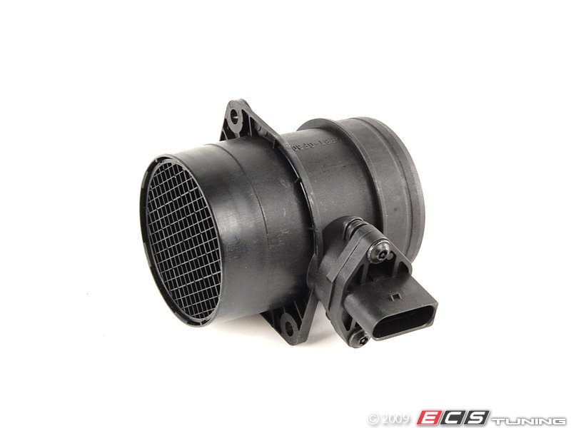

    I`m sorry but i do not understand what MAf means. Could somebody explain please?

    Quote Originally Posted by schubkarren View Post
    The timing chain looks okay, but I´ll change too maybe it`ll help.
    Mass Air Flow Sensor
    Looks like this

    The MAF sensor sits on the big air intake pipe. You can't miss it.

    Yes right between the air filters and the intake. I pulled the sensor on it off and there was not really a difference... That could cause misfirings because of passing on wrong results to the engine control unit?
    Yes, the wire inside the sensor is the problem. Before replacing it, you can remove it and try cleaning it with a spray cleaner for MAF sensors. A good auto parts store will sell this. At 126.000 km you might just need to replace it, but cleaning it could work.
    I wonder about the air leak reported by the computer. (?) Did you find any loose clamps or bad vacuum lines?
