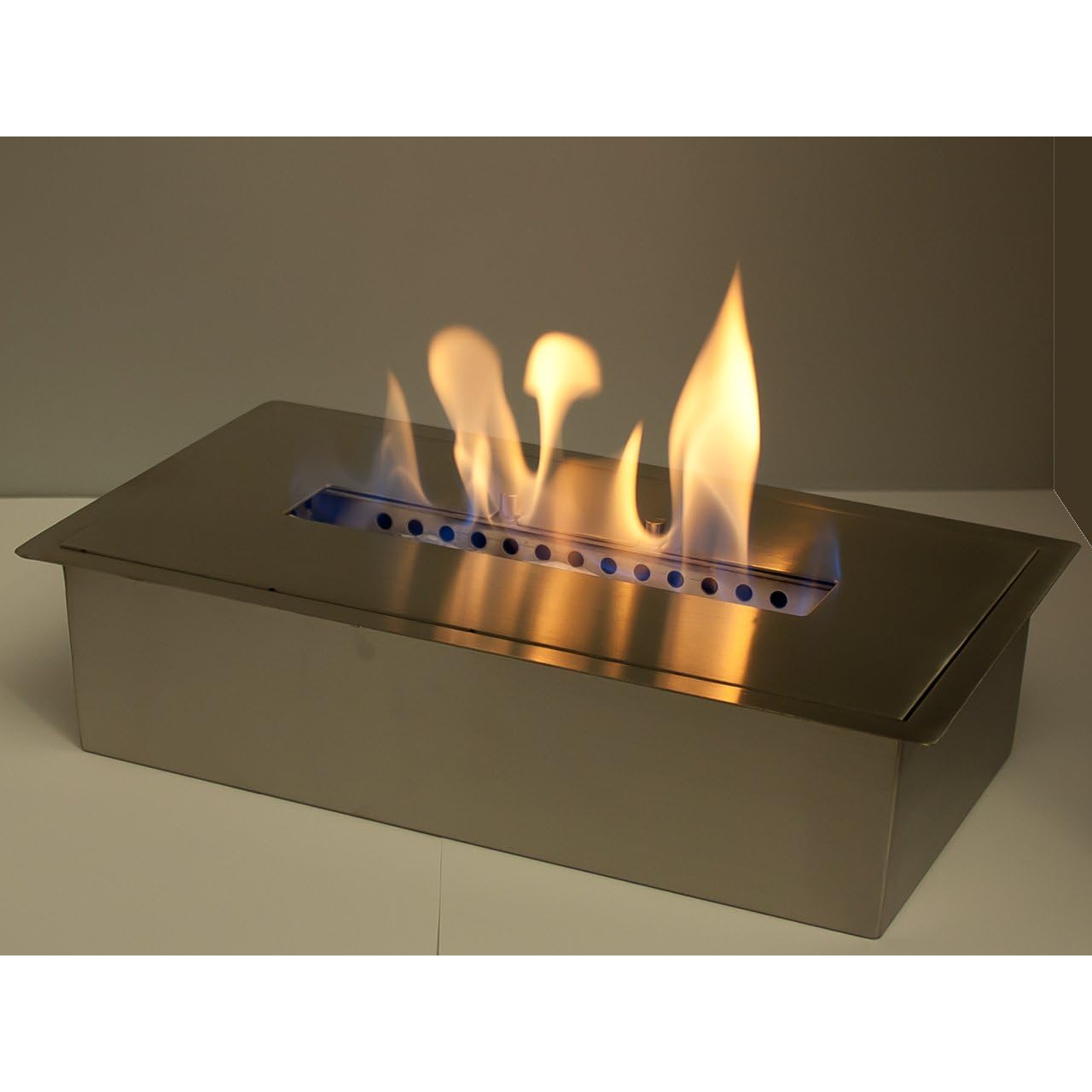

    You could look into a biofuel fire insert. No lines. Just cut an opening and drop it in.
    Interesting, I hadn't thought of that. I could certainly work with that setup. I don't think that the finished product would look as nice, but it would be cheaper than a pre-fab gas unit. I suspect that I can build my own propane unit for $170, including the fire glass. It looks like it would cost around $5 every evening that you burned the unit. A quart of fuel lasts 4-5 hours. If I had the unit on for a few hours in the evening, I could get two nights out of a $10 quart.
    You can get this 12" model on Amazon for $150. Click on picture for larger image:
