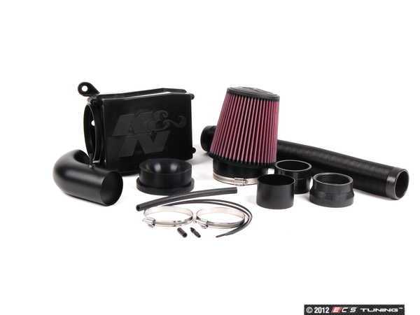

    Most of the 2.0T intakes out there don't have an TT application even though the space the intake occupies appears to be exactly the same as a Mk5/6 VW.
    I was on ECS' site and when I loaded the pages for TT parts, this K&N intake came up as a popular item.
    I thought "finally..." I called ECS and got very specific about the intake and my concerns that it was an application for the car and not just the engine. "Confirmed" they tell me, so I order.
    This arrived instead.
    After calling ECS another party confirmed that the intake above is correct and the first one pictured is not.
    I'd really like to know why. Anyone try to fit one like the first intake? Be it a Neuspeed, Carbonio, whatever? What's the issue?

    i agree with you i am on my second intake about to make a move to my third. the first one was an apr carbonio intake and dispute they said it would be a perfect fit it wasn't. why because it was too short so it was kinda hanging around in my engine bay. the second in take was the twin take by forge. it also had the same problem as the apr one so i then had to fabricate something to hold in place to get the most out of it. plus i feel that the second filter it has off to the side is pointless on our cars. because their is no air vent next to our headlights. the third intake shall be another one from forge which they had created just for their tt so I'm waiting for waterfest to come around so i can buy it.
  4. 04-26-2012 09:38 PM #4
    I have this intake for sale for a good price with a brand new filter. I can confirm that it fit's because we had it on my GF's MK2 TT 2.0T.
    The only issue with it is that the metal shield will not bolt up to the TT without a little bit of modification. Not even sure if it makes any difference anyways considering the placement of the filter.
