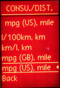

      Good thing all HID equipped US market cars have hi-line MFD. After setting EU or UK instruments, the odometer and MFD (and Climatronic if equipped) will be set to metric units. MFD lets you set them back to US standard units.
