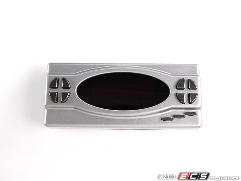

    when you say easy street management are you referring to autopilot v1? because lots of users have problems with that system.
    Hella4¯\_(ツ)_/¯ My Flickr
  18. Member Fuk It MkV's Avatar
    Jul 1st, 2011
    610
    2,637
    GeeTeeEyee on Pegadicks
    04-29-2012 10:14 PM #18
    Quote Originally Posted by Twilliams83 View Post
    This one
    | Instagrams: fukitmkv | I didn't build anything; I just bolted stuff on.

    Quote Originally Posted by Fuk It MkV View Post
    This one
    yeah i would personally stay away from that system.

  21. Member Twilliams83's Avatar
    Jan 24th, 2011
    Wildomar, CA
    4,923
    04-29-2012 11:39 PM #21
    What types of problems have you heard?
    Sent from my iPhone using this app that I paid 2.99 for
    if you do a quick search you will find all kinds of issues man. The accuracy is horrible.
