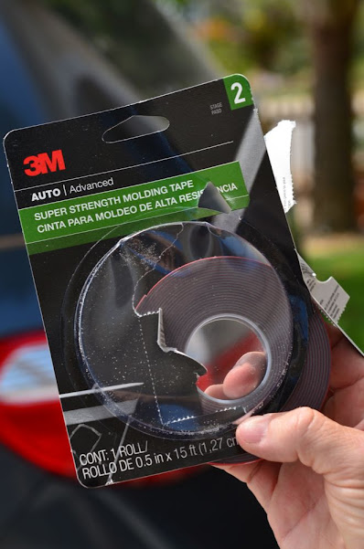

    • 3M double sided super duty tape: Auto-Parts Store

    edit: I used the 3m tape only, but I believe adhesive is like love and money: too much is just enough. Therefore, I've included GOOP on this DIY.

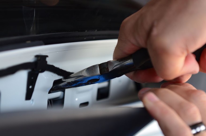

    3rd step, with needle nose pliers unclip all four white clips by squeezing the tabs together, you will hear click!

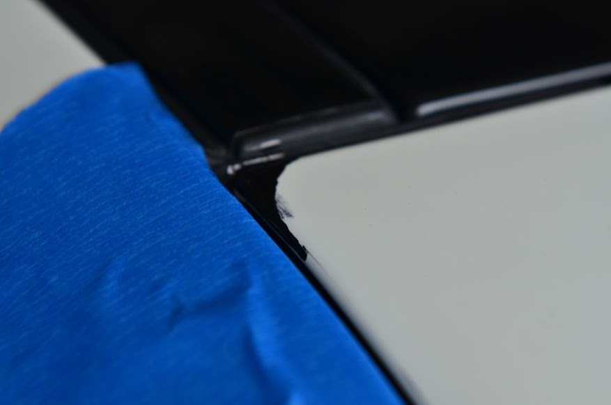

    5th step, blue tape the edges to save your paint!
    6th step, use the paint marker (mine is black, same color as the rear spoiler) to cover the corners where fitment is questionable.
    7th step, make sure you cover all four corners! You will notice that the rear spoiler has no hard corners, just curved rounded edges. If you do not paint pen these sections they will stand out like a sore thumb. Also, paint pen the edge of the body panels you are going to cover. I hate mistakes like this and cannot stand to have them on my car.

    I noticed you are using the 3m tape. I used it to mount a 12v socket on my motorcycle and it lasted maybe a month.
    I've had PMs saying the same thing. I'm going to update the DIY thread to include heavy GOOP usage as a secondary adhesive. The spoiler feels strong right now, but time will tell...

    Yep, USE the glue. The double sided tape is NOT enough...
