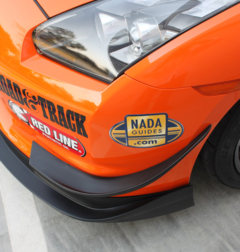

    5. Downforce: I really wish the car had more downforce at speed, but I don't think this is something that can be fixed without some serious modifications to the car. I don't want to make it ugly, so I'll just live with it.
    CarbonWurks is coming out with CF Dive Planes soon.... remains to be seen how tasteful they will look.

    I'm interested in seeing how the dive planes look, but I really don't want to have to permanently adhere anything to the body work. I wouldn't mind a simple bolt-on splitter or a small aero element under the front of the car. For those that don't know, our cars have 80 lbs. of lift on the front axle and 5 lbs. of lift on the rear axle at 120 mph. That's not much, but I would like to have some positive downforce at speed or at least 0 lift.

    - downforce - Jeremy, please get the dive planes. I wish to live vicariously through you.

    Dive planes. ???
    You all mean Canards, right.

    Dive planes. ???
    I know ..... just quoting exactly how the product is described on the website since they have no pics of it up yet
