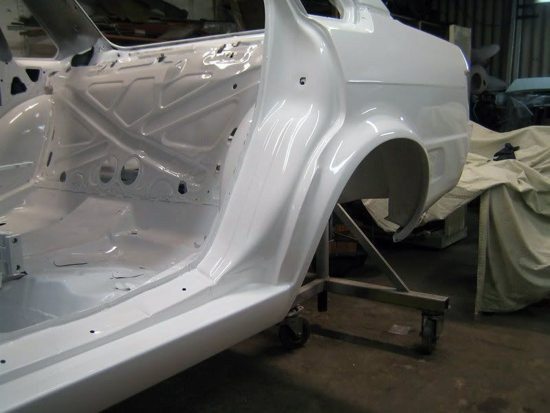

      Here´s my B2 project that I have been building for few years. Car is MY 1985 quattro, originally 1.8 8V engine. I am using 16V engine that was previously in my Golf mk2 project car. Car is still in progress, but hopefully get it working this summer.
      Car was already stripped when I bought it. I put engine in place so I could see how much space is needed for 3.5" exhaust. Also I mounted all suspension parts so I could see that how much fenders needed to be widened.
      After that car was stripped again and I rolled it over so could weld bottom of the car.
      After weldings were done car was transported to painting, where it was painted also from inside and bottom.
      Then all suspension parts were mounted and also fuel/brake lines.
      I also fabricated hood from glass fiber.
      Now car is in stage that windows and engine are mounted. Interior is almost ready. Maybe month or two and car is ready to be driven.

      I had problems to find any bolt-on solution for clutch. If I was using 5syl or 1.8t 20V there would be many options, but for longitunal mounted 16V I could´n find any.
      Heres some pics of clutch that I am using. Pressure plate is SRE which I used in my Golf mk2 and clutch plate is 4 puck sintered. Flywheel is custom made. I have some doupts that this could slip because it is only 228mm, but time will tell.
      Is someone here having a 16VT engine in 4000/80q? What clutches are you using?

      I'm in love with my 85 again. That is really nice. What trans and rear diff are you using? It looks like the more modern trans/diff. I have often thought of just dumping a 16V 2.0 in mine just for a little bump in HP but yours is sweet.

      I am using original trans and diff. In those pics rear diff is B3, but it has wrong ratio so I changed it to original B2 diff.

      Just curious but what did the flares come from? I'd probably go the UR Coupe GT fender flare on mine but those are really growing on me. I'm foregoing the 16V idea as I just picked up a NG engine with a 272 cam and other goodies for a song and a dance. I think around 150hp will do good enough for a snow car. Keep up the salivating work.

      Flares are Golf mk1.

      Thanks, you made them fit quite nicely.
