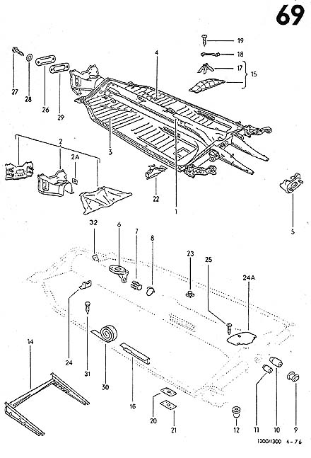

    Dayo cb ,please also check out this thread:
    http://www.chircoestore.com/catalog/...p?topic=7754.0
    & page 2 in this thread regarding the shifter bushing in the tunnel:
    http://www.chircoestore.com/catalog/...25491#msg25491
