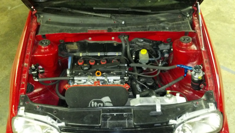

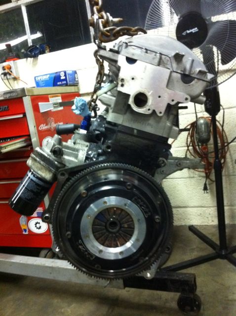

    Finally car is almost finished so figured it was time to share. I wanted to build something different after destroying my turbo car. Reused a handful of things and was able to sell alot of the turbo stuff to fund this project. Big thanks to Caste Systems Performance for helping me build the car, Lugtronic, and all my friends who helped along the way. We were able to bang out a 12.99@102 at the track still working out the best setup. Will be dynoing soon. Here are the engine specs:
    Wossner 82.7mm 12.3:1 Pistons
    Scat connecting rods
    FSI Crank
    Forcefed Engineering Crank Modification
    AEB head, Supertech exhaust valves
    Cat Gold springs, Rosten retainers
    Cat 3652 camshafts

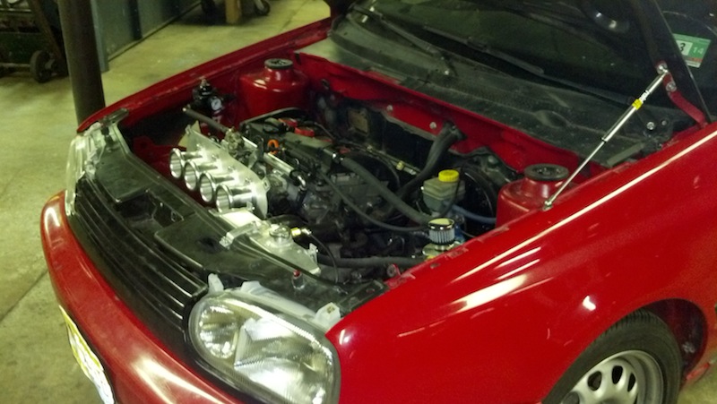

    48mm Throttle Bodies w/ Custom Manifold

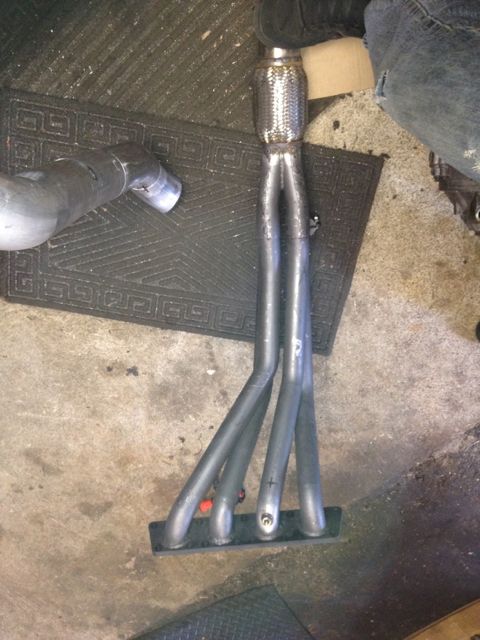

    Techtonics Tuning 4 to 1 Header (Then modified to 3" out)
    Custom ABF Alternator Bracket

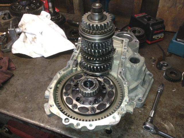

    Quaife Gears w/Peloquin LSD
    Clutchmasters FX700 Twin Disc Clutch
    DSS Stage 3 Axles
    Lugtronic Wire In ECU with Custom Harness with Bulkhead and lots of Data sensors
    Injector Dynamics ID 1000cc fuel injectors
    Bosch 044 Fuel Pump
    FuelLab Pre and Post Filters and FPR
    Full 3" Aluminum Exhaust
    E85 Fuel
    Engine Bay with Temporary catch Can

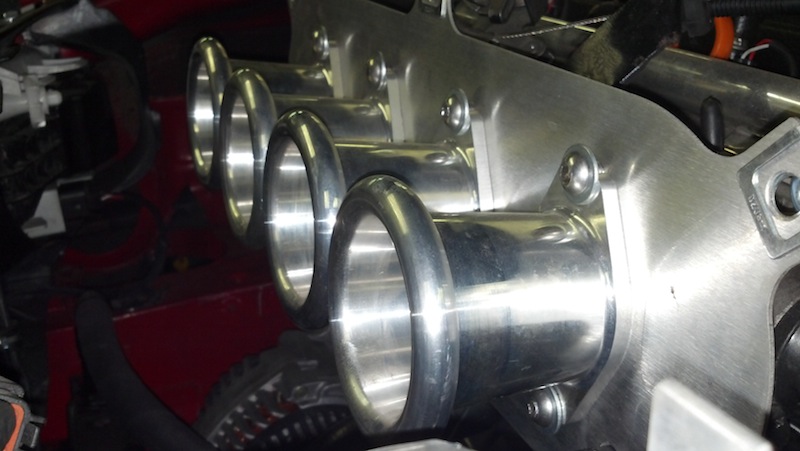

    Velocity Stacks

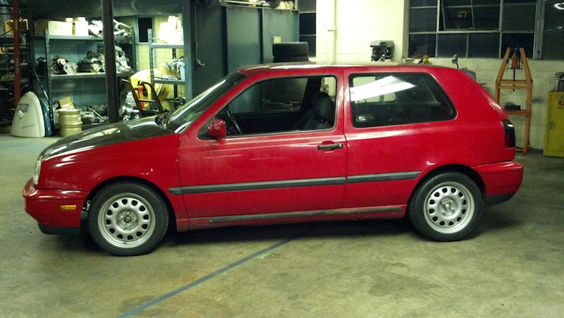

    Car in street trim
    Motor before it went in

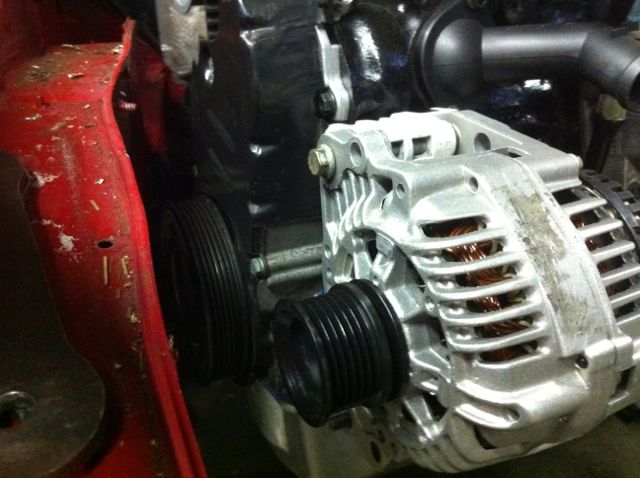

    Modified 06X accessory bracket with ABF alternator

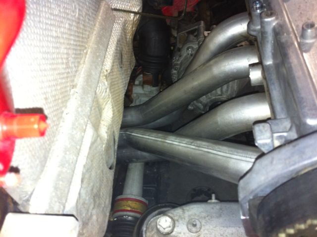

    Header fitment
    Modifed to 3" 2 1/4 just wasnt going to cut it.

    Im building the same motor for my mk3 right now. Can you give me some info on the ITB setup?
  27. Member
    Aug 7th, 2004
    Rockaway,NJ
    7,296
    94 golf
    08-20-2012 07:25 PM #27
    It is an ADR lower manifold mated to a flange from zornig. The flange is for Toyota ae111 or ae101 throttle bodies. The manifold was modified to get the proper angle. Velocity stacks from techno toy tuning. There are other lengths available but not easily in US and ITG filter with custom made plate. Custom made fuel rail and brackets. Custom made vacuum manifold.

    Hope you don't mind me adding more info in this thread. I also used an ADR manifold, then used 750 GSXR bike ITBs. With some all thread rod, nuts and/or washers spaced out for correct manifold spacing, and these were also the correct diameter for the ADR couplers.
    Keep it up Bonesaw, love what you are doing.

    Do you have any problem with the small throw using motorcycle throttle bodies? We have a car at the shop with extrudabodies and the pedal goes from idle to WOT in a really short distance. With the AE111 it has a more normal feel to it because they were designed for a car. I've heard that OBX makes knock offs of the Toyota throttle bodies for a honda. Someone should give them a whirl.
  34. Member d-bot's Avatar
    Sep 6th, 2004
    Par 5 from the Space Needle, PNW.
    10,529
    80 Storm 20vSC Syncro, 93 Corrado VR6
    08-21-2012 01:25 AM #34
    That was probably back in 2008 and it was only ITB'd for one summer. So recalling, it didn't seem short, but guessing shorter than a stock cable throw. The cable was actually a bike shifter cable to make it all work correctly. I'm sure there are better options out there that are more fit for automotive use, just wanted to throw that info out there as it's a cheap option. We all know that's not always the best choice though. The car ran great at WOT but was fairly touchy at partial throttle, which is probably part of the shorter throw you were asking about. Hope that clears it up a bit.

    For the bike throttles they are touchy unless you put on a progressive throttle cam from a stock tb or make a larger std one.
