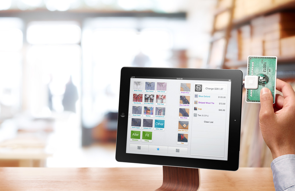

    If you want a pretty cheap system you could look at Square Register. Works really great and is dead simple to get working and support.
    You can also set up cash transactions with a cash drawer and receipt printing.
    The other aspect is the ability to easily collect information from customers to reward the regulars with special discounts and a personalized experience.
