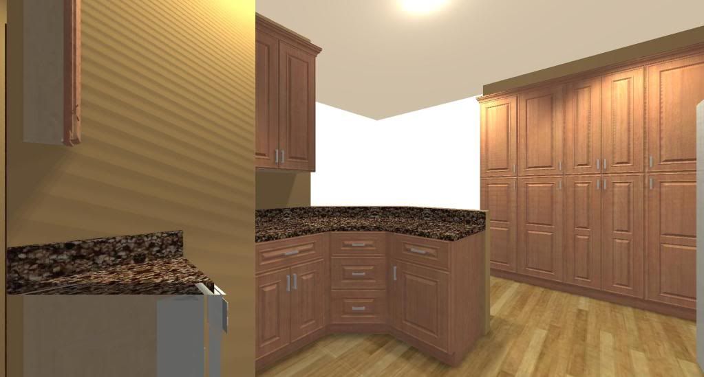

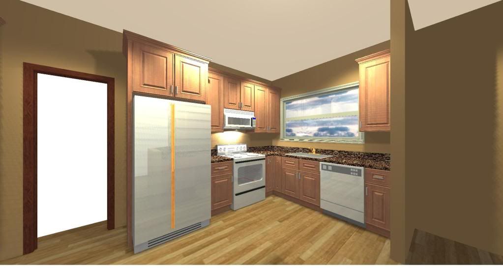

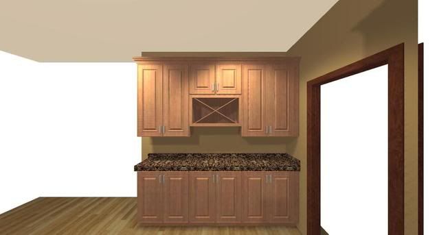

    I didn't like the Lowes design either. The wall placement was poor and the interior of the U is too small, as you said. Here's the final design (minus one thing I'll mention in a moment).
    This design still gives the additional counter space, but creates a larger U and provides a small bar and prep area. It separates the mud room without enclosing it as well. I am thinking of changing the cabinetry on the right wall though. I don't need the floor to ceiling models and will probably do elevated small cabinets separated by a nice wine rack. Something to that effect anyway, haven't really discussed this with anyone yet.

    Certainly gives you more counter space, and makes the 'U' bigger, but here are a couple of observations. No real room for storage in the laundry closet. And more importantly (again, this assumes they use the back door as a primary entry / exit door. That's a LONG walk around to get to the kitchen. There's also a ton of wasted space between the 3-drawer base and the other two cabinets in the island.
    As I said, I'd probably extend the counter to the door, and build the laundry closet on the outside wall where you're taking out those windows. With an open counter inside the door, you don't have to push it that far into the room (maybe 4'6" - 5' from the door). And the nice thing is that you could put a coat rack on it, facing the door. Plus it gives you the ability to see the back door from the kitchen (mom's like that). You'll end up w/ a standard 10x10 L-shaped kitchen. As far as the wall of storage cabinets, I installed a very similar setup to that last year. Full-height pantry cabinets on each end, w/ a standard height, 12" deep base, with a matching upper. Wine racks and hanging glass rack in there as well. Looked great.
    I would still change out the window over the sink. That long wall cabinet going into the corner is only going to be about half useful. Reaching all the way to the corner from the inside corner of the base cabinets is a LONG reach. I'd also make the laundry closet over-sized, so that you can store some cleaning stuff (broom, mop, etc.) in there, as well as a place for laundry stuff, and possibly some storage. How long is that wall?

    I like everything but the cabinet that bumps up above the stove. Did you state a reason for doing this? I like that it's deeper, but taller looks awkward, IMO.

    Quote Originally Posted by Crob View Post
    Creates focal points I guess, I just do what I see other designers doing.
    If other designers told you to jump off a bridge.................
    Seriously, do what looks good to you. You are the one that lives with it. Do what you want, not what others tell you what's right for you.
    I forgot about a microwave over the range aspect of it, I'm just trying to provide ideas based off of many people's ideas that came before me.
    I'm not some Rembrandt innovative architectural designer lol, just a average American kid that's well traveled that smokes more pot than society thinks a person should.
    You obviously put some time into it, and seem to know your way around 20/20 (at least that's what it looks like you used), but your designs require some major changes to the building. You've moved the door on the stove wall, you've changed the entry door from a LH out-swing to a RH in-swing (I suggested a LH in-swing), and more importantly, you've closed off the kitchen from the rest of the house (w/ the exception of the door you moved). I believe there's a door in the room behind the mud room, going towards the front of the house (can't confirm from the pics). It's the room shown to the left, in the pic of the refrigerator, w/ the white built-in shelf.
    As far as the 'out and up' look, yes, that's a somewhat common technique in kitchen design. I have seen it a lot w/ inside corners, and the end cabinets in a run. You also see it w/ decorative range hood covers. It really doesn't work the way you've shown it w/ the refrigerator cabinet. A couple of things I found when I was designing and selling kitchens. 1) Use end panels for refrigerators. Having an exposed refrigerator side, adjacent to a counter, is just a bad design. Things fall in the gap behind the refrigerator, and it is just an unfinished look. 2) Use at least a 24" deep cabinet above the refrigerator. Shallower cabinets usually lead to things getting placed on top of the refrigerator, in front of the cabinet doors, rendering the cabinet pretty much useless. Also, I imagine if you threw some crown moulding on top of the cabinets, the stepped-up cabinet over the range wouldn't look as awkward.
    And just a side note, it looks like you've done this w/ 30" high wall cabinets, not the 42" ones the OP is considering, since the room has 9' ceilings.

    Quote Originally Posted by Mk1Racer View Post

    Here's the final design.
    Here's the new cabinetry replacing the pantry option from the first page.
    Here's the shot looking in from the back door. The shelf will be filled in.
    Here's a couple more floor demolition shots for the hell of it.
    And here is how it currently sits. Filling in the windows in the original mud room sometime this holiday weekend.
